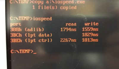

Reply 151 of 566, by SteveC
Hi pdw,
I get on a normal boot with EMM386 etc etc running:
433.86 KiB
3025 views
And this gives me screeching distorted sound using opl2test.exe.

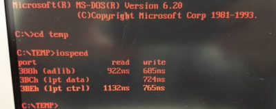

On a completely clean F5 boot I get:
262.05 KiB
3025 views
And this just gives silence.
Don't you just love the orange gas plasma screen? 😁
I thought it might be grounding/power because I was using USB for 5v on my Thinkpad and that works, but if I used any other power source it turned out it didn't work. So I made up a PS/2 mouse port to 5v cable and that still works on the Thinkpad but doesn't help the PS/2 386.
Cheers,
Steve
Reply 152 of 566, by pdw
Those timings should be good, in both configurations... I don't think it's a bus speed problem. Still it's strange that it does seem to have an effect. Just to be sure, here's a version of OPL2TEST with all delays doubled: https://2k38.be/adlipt/opl2tes2.exe
I can't find any mentions of PS/2 systems having incompatible parallel ports. They did add the bidirectional mode, but the software is not enabling that, so that should be fine.
Do you have other stuff that plugs in the parallel port? An old printer, Covox device, Laplink cable? I guess with old computers there's always a chance that a part is defective...
