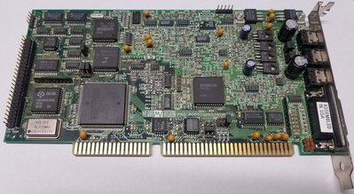

First post, by Intel486dx33
Is this card any good?
Has some embedded chips like Yamaha and maybe Crystal ?
These where popular back in early 1990's
Is it okay for a retro build ?
    299.75 KiB
    3600 views
