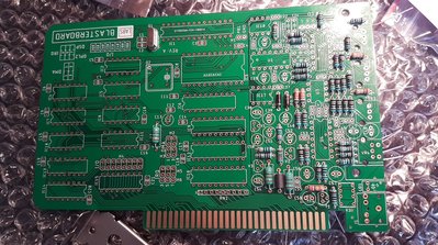

Reply 216 of 555, by MJay99
Oh, most definitely, this already IS my first xmas present this year:
A pack of goodies:
1.28 MiB
1325 views
A pack of goodies
A 30 minute lunch break well used (with elegant help of a little recently discovered chinese magician):
705.76 KiB
1325 views
941.28 KiB
1325 views
A little chinese magician

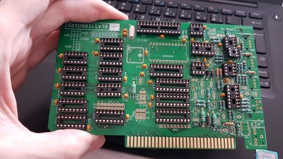

Pondering if socketing all ICs would be looking ok (hint: it doesn't):
783.71 KiB
1325 views
Pondering if socketing all ICs would look ok - but it certainly doesn't.
So I just checked all the logic ones in an eprommer I brought back from China a short while ago and went for it (definitely not necessary, but also didn't hurt):
786.27 KiB
1325 views
ICs and most capacitors added.

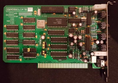

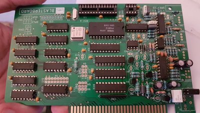

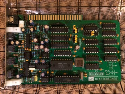

Reply 217 of 555, by MJay99
Et voilà, after about five hours of non-stop fun, this is what I came out with:
159.64 KiB
1319 views
done.
My personal findings and take on the process:
It's a breeze and I love the included building instruction! It's such a nice touch!
There's maybe only one very minor change I would recommend to it, which is:
soldering the headers H1, H7, H8 a little earlier in the process (maybe right after the ICs), as they were a little difficult to position later.
With the film capacitors, I was happy to have that little gadget to identify them, but it's certainly no problem sorting them out otherwise - even for an amateur.
The soldering itself needs a bit more care than on e.g. the Snark Barker - there's less spacing around the solder pads. Also JCLs solder-mask seems to be a little more thin than e.g. Elecrow's where I happened to get that PCB made.
Not really worth a mention, but almost funny that obviously they didn't want to take up the hint for their batch marker again (like it happened on shock__'s ARGUS order, too) and put it under the ATMEGA's position, instead of the OPL 😁
Everything else is as already mentioned before: the bracket fits perfectly and the nylon holders are rock solid!
So much for today's fun - cleaning and testing will have to wait for tomorrow 😎
