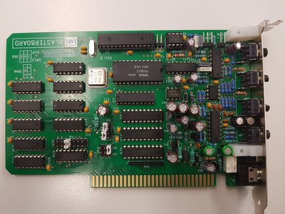

Reply 371 of 555, by FreddyV
Hi,
I finished the board and it worked the first time I plugged it in my PC1640.
Unfortunately, I removed it to change the IRQ and it does not work anymore. 🙁
I tries to remove / Plug back multiple times and to clean the ISA Slot, it still does not work.
(Not Detected by Mod Master and other apps)
The adlib part is still working.
Will you do new batches ?
Reply 372 of 555, by Cyrix200+
FreddyV wrote:
Hi, […]
Hi,
That's unfortunate, but that might be fixable. My first thing to try would be to check/re-flash the MCU. Others might have much better ideas than me though 😀

Reply 373 of 555, by FreddyV
Yes, Check the MCU, but I suppose I need special hardware for this.
I have an universal programmer (I never used it yet), a TL866, can it be used for this ?
Or I send the board back to LABs so that he check it.
Reply 374 of 555, by Cyrix200+
TL866 should work. I am not at all sure it's a useful thing to do at the moment though. You could put in the MCU and try to read it with the TL866 and see what happens...
1982 to 2001
Reply 375 of 555, by FreddyV
Hi, In a picture, I see that there are 2 jumpers on the IRQ Part.
I don't know how they are supposed to be configured.
Anyway, it was working before, the problem is not there.

Reply 376 of 555, by Cyrix200+
FreddyV wrote:
Hi, In a picture, I see that there are 2 jumpers on the IRQ Part. I don't know how they are supposed to be configured. […]
matze79 had similar problems: BLASTERBOARD : A new SB 2.0-compatible ISA sound card
Also check all solder connections, clean of flux from board.
1982 to 2001
Reply 378 of 555, by LABS
FreddyV wrote:
A dit stopper To work after i removed it To change the IRQ i dont thinking is a Soldering problem
IRQ settings are printed next to the logo, so on your photo it is set correctly to IRQ 7. Does it work on your previous setting?
Please PM me with a photo of a solder side.

Reply 379 of 555, by matze79
Yeah my MCU was dead, because of power supply issues, i replaced it with a new one which did the job just fine 😀
i tried to rewrite the old one with the TL866, but it had verify errors, flash failed.
