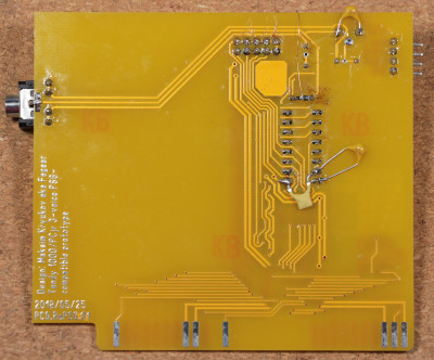

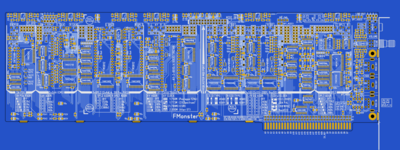

Two more months passed... I've fixed some errors in some blocks and rearranged those on the board.
New order (left to right): SN PSG, 2xSAA (CMS), 2xOPL2 (2xAdLib, SB Pro), AY (CSM), 2xSID (2xSSI-2001, DuoSID), OPL3.
183.38 KiB
1825 views
FMonster @2019-12-12
New BIG soundcard: FMonster.
Covox Sound Master replica
Innovation SSI-2001 replica & DuoSID.
My audio/video collection.

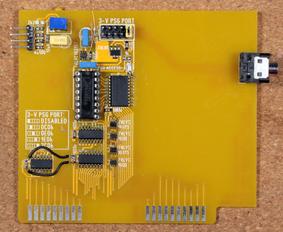

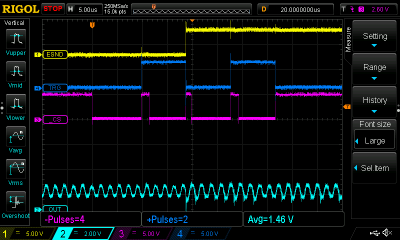

Reply 226 of 275, by Fagear
I've finally got to test the "3-voice PSG" board (SN76489)!
And it works just fine.
Of course there were some minor bugs as:
- I've forgot to connect power to one logic IC that provided clock for SN76489
- Some capacitors and resistors needed to be added to reduce noise level
- I've connected LED to the wrong rail and it didn't light up on access
Everything else is fine.
Address decoder works, data bus buffer works, "garbage-tone-blocker" logic works (SN76489 doesn't have a reset circuit and starts to produce random tones as soon as power is applied), power regulator does not overheat.
After noise-reducing tweaks I've managed to get less than -60 dB of noise on the output.
Games that should work with "Tandy 1000 sound" work fine. TSRs from TNDY and Lotech projects help a lot.
I've finished filming a video about debugging and testing of the board, but I have not put it together yet, so no audio samples yet.

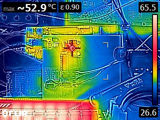

Reply 232 of 275, by Fagear
awgamer wrote on 2020-01-12, 10:10:
One of those cheap heat map guns on ebay?
Exact opposite. Flir E4. Bought it recently.
