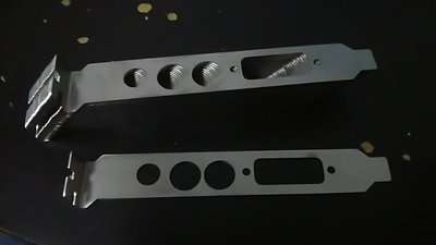

I have custom brackets (still in china) ! Next card uses RCAs for line out, the line in is still TRS based. The cost is something near 1.25€ per bracket. I don't actually know anything about the company who did them, this stuff was arranged to me by a friend in China.
I am also gonna use a larger CPLD and I have a thought that might allow me to fix the problem with freezes on 486. I plan to buffer the entire address bus and only pass it to the YM when ALE pulses (indicating completely stable address lines), this should hopefully clear out any misfires that the chip sometimes seems to experience. Another option is to do most address decode on the CPLD side, which I think I can do also. In any case I am confident I can fix the 486 freeze.
I would love to do Disney Sound Source also but there's no way I can fit full sized FIFO into the CPLD, only few levels at most.
I'm also going to Norway on december 13th. I don't think I'll have any cards done before that, especially since I have some other things that must take priority first. The project that allowed me to get this far got delayed by a month and few other things including this card got delayed due to it also...
Reply 132 of 268, by SaxxonPike
Take all the time you need! These brackets look great. Looking forward to the next batch 😀
