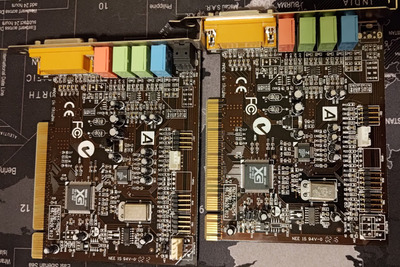

As long time "normal" AW744 II (P/N 55.18610.631) user with added PC_PCI interface I decided to acquire Pro version (P/N 55.18610.631) with Digital I/O.
So few confirmations from real card holder. Basically confirming Kodi findings.
TOSLINK module is indeed TX178S. Aliexpress current pricing starts from 1.5 EUR

Anyways I might try to convert my old card into Pro version. Probably the biggest challenge for me will be trimming bracket window nicely for TOSLINK module. I have only dremel so result will be not esthetically pleasing...
