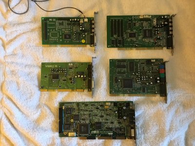

Which sound card has the best compatibility with DOS games and sounds the best ?
Is easy to install and setup and is reliable in sound quality ?
Here is what I have:
1) ESS 688, ISA
2) Sound blaster 16 vibra with Yamaha OPL3 chip. ( YMF-262 ) ISA
3) Sound blaster AWE64, ISA
4) Sound blaster live ( PCI )
5) Sound blaster live 5.1 ( PCI )
6) Yamaha Audician32, ISA
7) Turtle beach Monte Carlo, with Yamaha OPL YMF-262, ISA
8 ) ESS 689
9) Crystal audio, ISA
10) Advanced logic, ISA
11) Media Vision pro audio spectrum PAS16P , with Yamaha OPL YMF-262, ISA
12) Sound Blaster Pro 2.0 , with Yamaha OPL ( YMF-262 ) ISA

FM sound ranked from best to worst:
1) Real OPL3 (YMF-262 and variants), any Yamaha card, many SB16 cards
2) ESS FM synth, some Crystal synths
3) CQM synth (SB AWE64, Live, some Vibra cards)
4) Some Crystal cards have horrible OPL3 compatibility and sound like crap
DOS compatibility:
1) Real SB16 or SB Pro II, with jumper settings (non-PnP)
2) SB16 PnP, or Vibra PnP (these can be initialized without TSRs), many ESS or Crystal cards, Yamaha 719 etc.
3) SB AWE32/AWE64 (these only really shine in Win9x)
4) SB PCI or Live, or any other PCI card (PCI cards are all very bad for DOS compatibility, you need ISA for great compatibility no matter what)

I have some Sound Blaster Pro 2.0 and Vibra 16x with Yamaha OPL ( YMF-262 ).
I should choose between these 2 right ?

For a DX-66 the genuine SB Pro II is the superior option.
No, of course you don’t need a separate Adlib card. That’s the point of owning a Sound Blaster.

If you want a simple setup, choose between AWE64 and Audician32+Dreamblaster daughterboard. First gives you a no-frills SB16+AWE synth in DOS, and General MIDI in Windows. Second gives you SBPro compatibility + real Yamaha OPL + General MIDI.
If you have enough ISA slots, and can deal a bit of with IRQ hell, you can even include both in the same PC and maximize compatibility and supported features.
