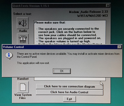

I installed this driver for my MWave MDSP2780 but I got no sound because there is no mixer:

RiP wrote on 2020-12-29, 21:12:
http://aptivasupport.com/20d_setup.html
Get anywhere with this yet?
I can't even get a MDSP2780 (765D) working in Windows 98SE. The limited BIOS shows on the test page as "DSP" available, "audio" unavailable (I assume this is normal). In Windows I've tried to "add new hardware", and no non-pnp devices are found. I forced WIndows 98 Mwave drivers on an "unknown device" in the device manager, and then it seems to get 2 of the 3 expected resource allocations (I/O 4E30-4E3F, DMA 07, but IRQ 10 instead of 9 or 15). The Thinkpad Configuration program I installed doesn't show a "DSP" option per a page I found referencing setting the wave audio working, but the configuration program's "audio" page says that the device doesn't exist. It shows up in there under the Allocated Resources View, with the driver name I force-loaded onto "unknown device" earlier. I've tried drivers IBM Thinkpad Wave Device and Aptiva Modem Wave Device, which seem to be the same thing, but still no sound. I also tried the 3-disk MWave driver, selecting the appropriate addresses, but I cannot select IRQ 10 using that driver installer. The device manager won't let me change it off IRQ10 (I assume it's hard-set there, being non-pnp).
I have no clue where to go from here in getting any audio working in Windows 98SE. I didn't have luck in Windows 95 OSR2 either. Lots of breaking things, and re-imaging my CF card back to a clean slate.

Which driver should I install?
The mixer doesn't work at all.

Reply 27 of 28, by Sky92
RiP wrote on 2021-07-20, 16:31:
Did you ever get it to work in the end?
I'm reviving this topic as there seems to be no more recent MWave topic at all, and this has been the most extensive and helpful so far...
I got my dream 1996 Aptiva a while back and had great fun restoring it.
Thanks to this topic I managed to get my original MWave Dolphin card working well using the 20D Drivers from Cyclone3D's Google Drive.
Carefully following the instructions, it was a little unusual to do but actually worked straight away... (With this driver set at least, I failed miserably with other drivers first as well)
But it basically works together with W95's standard mixer since the hardware was installed.
My problem is however... Because I'm not an expert, and so I have no idea if this is a software or hardware fault...
Everything on my MWave card works surprisingly well... Except my CD-Audio input...
The same CD Drive with the same CD audio cable have worked on a Soundblaster 32 that I had in there for a while... So it's not those two...
Both playing an audio CD through windows, as well as CD Audio in games doesn't work at all...
However, CD's are recognized and played... Winamp will even get it's EQ VU's dancing on it...
What can be the problem here? Can this be a software thing or is it a PCB level problem that needs attention?
