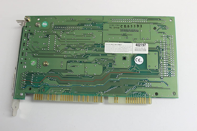

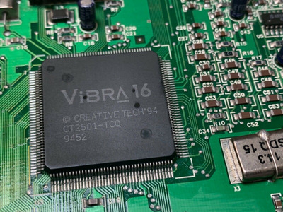

Reply 17 of 19, by stevenh
Talking to myself, it occurred (to myself) that I could just find hi-res images on Google and trace the traces. I've managed to determine MIDI-OUT Pin 12 is hooked to the 11-th pin 'up' (aka Pin 30) from the bottom-left of the CT2501 when looking at it with the text level.
In the images, blue is midi IN (pin 15), red is midi out (pin 12). On the chip side, MIDI OUT is followed through and traced in yellow, directly on the bottom-left of the CT2501 IC.
MIDI IN runs somewhere under an IC bottom-left and I am not able to trace it from web images.
From here, the goal is to run a trace from this pin on the DOS Compatibility Sound Card and then somehow feed it to the joystick port plug.
I'm thinking a 3.5mm audio jack in the plate with a secondary plug that comes from the hydra cable (of which I made my own, so wont need to try and rip one apart)
Also unhook the +5v and GND in the joystick cable port as they're hideously wrong.
Will update as the project progresses.
