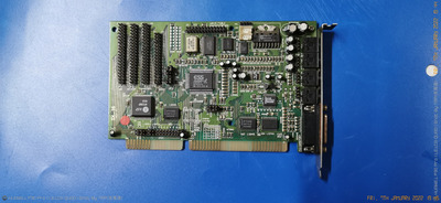

Good Day Appiah4 & ESS owners and Vogons users...,
Sorry to necro this old thread...I just recently bought this card for a very fairly cheap price,.... so I getting this card for a Pentium 166 MMX (My lowest Retro computer in my home.. I do not own a 386 nor 486..).
I saw your card, and it is pretty much identical to what I have... (yours is "Gold-16 Rev 3.2B" written on your PCB... while mine is "SX_16 Rev 2.1").
I have attached the picture (Sorry for low quality).I been vogons/googling research about this card, before I even post the question here.
So bear with me, if my question are "too silly"...a. Base on your Picture, JP2 - "CLOSE ENABLE SOFTWAVE ADDRESS FOR ES1688 CHIP ONLY" . What that jumper does? what does it do?
(Because mine, it is stated "EN" and that's all. Don't know what that does...)
b. So, Since my board, is quite identical as yours, which driver do you use? I want to try to same drivers as yours, and test it.. 😀Appreciate your feedback on this....
JP2 is SOFTWARE ADDRESS (not SOFTWAVE ADDRESS) and only relevant for enabling/disabling PnP initialization for ES1688; for your card it is useless.
I used these drivers:http://vogonsdrivers.com/getfile.php?fileid=1461
