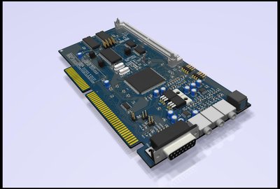

My card is essentially clone of Argus. I was too late to participate in Argus project, but thanks to __shock who published the schematics I was able to lay down my own PCB and got something like this:
157.21 KiB
1292 views
my gus pnp clone
Today I tried to fix possible lousy joints on Interwave (resolder it) and replaced latches and 'or' gates (with not too much hope for success, but it was easy enough to do).
Nothing helped so I have two guesses for now, either my PCB design is bad (a mistake, or just crappy design with parasitic capacitance or something) or Interwave failure. The later is supported by the fact I used second hand Interwave chip. I got some of them in good price, they came on machine cut pieces of pcb obtained from old soundcards (green pcb, I guess compaq cards). I have no idea they were taken from working cards or some customer returns faulty ones. Additionally the chip could have been damaged during the cutting or during my de/re soldering. As a next step I'm going to build another board with Interwave coming from the other source. It should help me ruling out one of these hypotheses .

That's impressive! You have a TOSLINK header on your GUS clone? That is awesome!
Did you rule out the ISA timing issues like 640K!enough mentioned?
Attached you'll find the XM files used by the demo. I would try those both in Impulse Tracker with the Interwave driver and FastTracker with classic GUS support to see what it does. Seems there might be some looping going on what causes the issues.

Unless there is a more significant problem with your design (or the assembly job), the latches and ROM IC have no effect on the functionality you are testing. This demo needs only the InterWave and some usable RAM. Try leaving the ROM and latches off altogether, if you build another test board (that will mean no ROM-based MIDI playback initially, until testing is complete).
Have you run the RAM test from within the Gravis SETUP.EXE? Does it pass consistently, while also detecting the right amount of RAM?
Lastly, make sure that you are not using flux that is conductive when soldering. If there is any residue left on the board following assembly, that may lead to very strange problems, as you can see if you read the account of my mini-disaster here. However, if simply running iwinit fixes your problems temporarily, that may not be related.

I tried it on 2 different pcs. The BX boards, compaq with very poor bios (very limited settings) and the other one wth regular Ami or Award BIOS. I played with what I could, but always the same, thus I think its not related to ISA settings.
Regardinng the toslink transmitter. I have a plan to add it thus why the board is designed with this transmitter and three 2x2 pin headers around the MX chip with needed signals. My first candidate is CS8420. This is athe S/PDIF transmitter with SRC. The maximum rate ratio for CS8420 SRC is of 1:3 (3:1) thus in theory should be capable of upsampling the lowest IW output rate of 19293Hz (above 31 channels in GUS emulation mode) to 44.1KHz output.
I haven't done much in this. For now I only set up the the virtual machine with windows 95 and compiled the iwinit.exe which will have to be modified to switch interwave into serial transmitting mode.
@640K!enough
I didn't expect latches replacement to help neither. I tested the rom and it was working correctly (the checksum of dumped rom was correct and midi files played correctly). My plan was similar to your advice, build the next board without rom and with 1mb ram only and test the basic things first. The current board is slightly dirty with the flux. This flux supposed to be non-conductive, but I'll try to give it good wash with IPA and test again. I ran the ram test every time I changed the ram configuration so it passed it for 1MB, 4MB and 16MB (simm). The ram capacity was also detected correctly each time.

Reply 12 of 12, by pand
Spending some more time on this I tested numerous theories. It came out that simm module was working correctly while problems were visible (or rather hearable) with onborad ram only. Keeping it short I found that in some case memory writes were wrong. Sometime bytes were written in the wrong address. Memory reads were always ok. I did what I could including rerouting the board few times with no success. In the end I swapped the onbord ram and rom. In such config the simm and ram are approximately equidistant from IW and the onboard ram is nearer the IW than in the original config. This fixed my problems. Today (2022.11.05) I listed one of my boards on ebay. Thanks again to all for their help in this thread.
