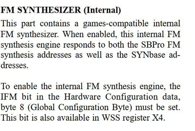

Reply 479 of 631, by MJay99
@JazeFox: Is, or would it be possible, to use the Orpheus' /XOFi & /XOFe option with any CS423x card?
Reason being: I added an OPL to a card with a CS4237b and would like to switch between the internal and external FM without going through reprogramming the EEPROM... In the datasheet it seems to be possible by setting a register, but in my first attempts trying the above options on this non-Orpheus card it didn't seem to do anything.
