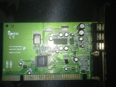

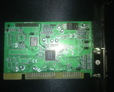

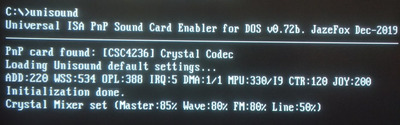

Ok, I tested a new batch of cards:
-ALS120, ES1868F and proper OPTi 82C931 (with a 14.318 Mhz crystal oscillator), all worked great.
I had problems with 2 cards, both with Crystal CX4235-XQ3 chip.
-1st one (generic) appears to be non-pnp so I cant seem to initialize it with Unisound
-2nd one (Genius) its a PnP card, it gets initialized, but I can't get ANY sound on any game. What could be the problem? Do you need a dumpp?
EDIT: all Crystal CX4235-XQ3 cards are dead...

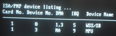

JazeFox wrote on 2020-06-26, 20:09:
Oetker wrote on 2020-06-26, 19:23:
My Compaq Deskpro's built-in ESS isn't detected. I already uploaded a dump before: download/file.php?id=81157 PNPBDV07.TXT
I don't see any ESS card in those dumps. I only see an Aztech 2320 card there.
What ESS chip is mounted in your board?
That text file contains the card info, ES1869.
Esscfg works fine.
What is strange about this system is that disabling devices in the bios still means windows sees them, but can't assign resources. You have to 'hide' them in the security settings to completely hide them from Windows.

Just to be sure, here's a dump with the card fully configured and playing sfx in Doom.
