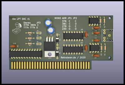

Revision Update:
118.5 KiB
1035 views
i don`t think it makes sense to make Quad DAC just use two Dual Cards and mix Outputs.
There is really only one Program Supporting it 😀
Now Mono Playback on LPT Adresses, Stereo on different.
Still have to choose "hopefully" Conflict Free Adresses, any Suggestions here ?

matze79 wrote on 2020-11-22, 17:11:
Consider 16-bit address decoding - this would allow addresses like 378h+400h, 378h+800h, 378h+C00h, and so on...

Reply 23 of 35, by root42
Or: Use 16 bit port writes. I.e. 378h+379h to be able to write both L and R samples with one 16 bit out instruction.

Reply 24 of 35, by Grzyb
BTW, I've found a special LPT card which can be set for both standard and non-standard addresses:
3BC
378
278
268
27C

@matze79 A bit of topic perhaps, but can you perhaps share the workflow you use to get such high quality visual renders of KiCad designs?
Recently I rendered a 3D image of a KiCad design of another project (using the example instructions found at Hackaday), and importing into Blender and such proved quite a hassle. I eventually got it to import properly, but I didn't even come close to getting the quality that you got, because I skipped on a lot of the suggested tweaks described in the guide at Hackaday. Perhaps you found a more automated script somewhere that can do this for you? Or are you just very experienced and proficient with Blender (or other 3D rendering tools)?
Thanks. 🙂
Reply 26 of 35, by matze79
You just have to change the 3D Preview to ray tracing.
It’s part of Kicad.
https://kicad.org/discover/3dviewer/
Reply 27 of 35, by digger
matze79 wrote on 2020-11-23, 23:28:
It’s part of Kicad.
Ach so! 😅 I've played with the 3D preview before and I wasn't impressed with the quality, but I didn't know it also had an actual high-quality ray tracing option. I should have examined all the bells and whistles of KiCad better. Thanks!

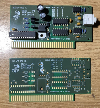

R1 arrived and works as expected 😀 looks bit ugly because of desoldered parts but! it works!
No longer flip switches for Mono / Stereo
My First PCB with KiCad

Are you still working on this design? Have you tried adding DSS support? Is the r1 available for sale either complete or as a kit?
Reply 34 of 35, by matze79
Yeah, i have a new design on draft for 1 year but didnt order it yet.
it supports auto detection as lpt port so debug is no longer needed and also auto stereo mono switching.
No there is no shop to buy it.
I also didnt upload the files to github yet. i was just too lazy, eager to do other stuff 😀
only 3 cards where ever made.
