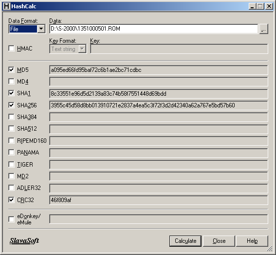

I can confirm the 1MB "1351000501" ROM has CRC32 as per the attached picture:
9.13 KiB
616 views
plus it's controlled by "SNDSCAPE.CO1" firmware.

OK, what I can gather so far:
* ROM: 1350901601 (2MB), CRC32: 9FDC4825, FW: SNDSCAPE.CO0
* ROM: 1351000501 (1MB), CRC32: 46F809AF, FW: SNDSCAPE.CO1 is the firmware that controls it
* ROM: 1351000801 (1MB), CRC32: 1B696EFE , FW: SNDSCAPE.CO4

I can confirm the CRC32 of the 1350901601 ROM.
ROM 1351000801 has CRC32 1b696efe here.

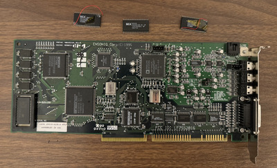

I received the SOP44 M27C160-100M OTP EPROMs, and it looks like upgrading the "Odie" card from the 1MB ROM (1351000801) to the 2MB ROM (1350901601) works using those chips. Only tested a bit of General MIDI in DOOM and Duke Nukem 3D.
Still looking for the 2MB ROM from the Elite 😀 and the daughterboard 😀.
    1.27 MiB
    172 views
    Upgraded Soundscape Odie card

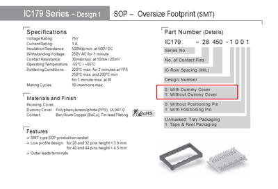

I recently found very cheap Yamaichi such socket and bought it, it's new, but it was missing the "black cap" - I don't know how to call it - the black rectangle on your picture that holds the chip in the socket. So, if anyone knows if it's possible to buy just such "black cap" that completes the socket - It also will be helpful.
I am using the Yamaichi IC179Z-44600 socket. I have never seen the covers sold separately, but I also found very few places that still sold those sockets anyway.
thanks and mine, the one without the cover, is the same Yamaichi 179-series.
florian3 wrote on 2023-12-05, 15:21:
their datasheet is talking about "with and without dummy cover":
79.66 KiB
48 views
I think what i have is "with dummy cover", because it has a cover, but to protect the socket pins, not cover to hold the chip in the socket. So, I guess the variant "without dummy cover" has the chip cover, which I guess serves both to protect the socket pins during transportation and to hold the chip in place.
