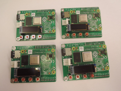

inching closer to doing a production run.
next batch of 4 working perfectly fine,
thanks to PJ for soldering assistance.
Thanks for your support !
Nice! Can you provide a step-file of the whole board? I'm planning to make a standalone case for it.
