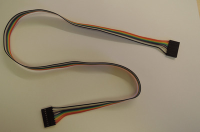

Hi ,
more progress,
the 60cm custom cable samples arrived and look good,
also received more CM4 modules,
and the printed 3.5" panels in cream white and black look good, design of this is final too..
So I will have some full sets including 3.5" panel available the next days/weeks, and will be contacting people that are on the wait list.
(If you are interested in early bird sets, before november, you can still pm me of contact through https://www.serdashop.com/Contact )
The large batch should be ready by end october, and from then on McCake will also be available from the webshop.

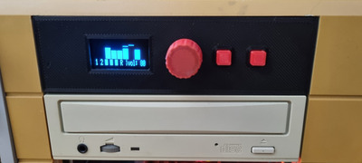

In the meantime, I finally had time to test my custom DIY front bay. It seems to work well 😀 Find it here in case you are interested: https://github.com/bzeiss/retro-pcbs/
By the way: for the cable, I ended up simply using a 20-pin IDC cable and connected only 9 pins of it.

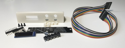

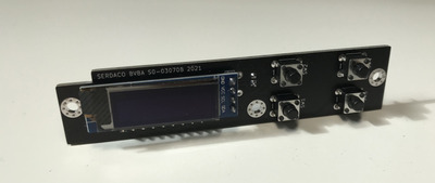

Dreamblaster was kind enough to provide me with a panel as a kit. It was very well packaged.
I don't want to withhold the result from you.
Here is the kit:
548.32 KiB
1789 views

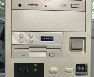

The assembly is done in 15 minutes. Here is the result:
465.59 KiB
1789 views
316.59 KiB
1789 views
512.55 KiB
1789 views
1.35 MiB
1789 views
Overall, I find the panel very appealing and can recommend it to others. 👍🏻
In terms of color, it goes very well with this case.
For my personal taste, however, I think it would be better if the plastic was more matt and not quite as shiny.
Furthermore, I don't have a recess in my case for fixing the panel to the two corresponding screw holes. I haven't found an elegant solution for this yet.
Perhaps there is the option of a larger panel variant so that the standard fixation can be used as with a floppy disk drive.
I tried the panel on other cases of mine, I think the light gray or white variant would probably be better for one or the other.

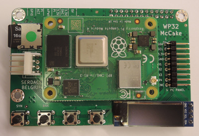

New Mc Cake revision,
just a few prototypes as final test for production run.
I expect to have the production batch in november.
