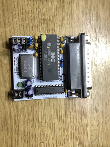

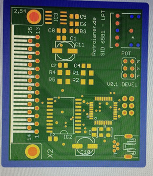

i started some time ago to design a SID LPT Testing Plug ,
473.09 KiB
408 views
but Kanpai from dosreloaded.de got the same idea almost same time and already ordered some PCBs.
So he send me one.

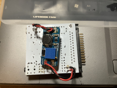

I added a DC-DC Booster for real SID IC.
Both are based on the Design from:

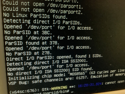

But it seems Vice has some Bugs in its LPT SID / PARSID Support.
If it gets correctly detected it will crash with Memory Corruption.
I will report back with more News when we get Vice running correctly!

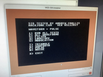

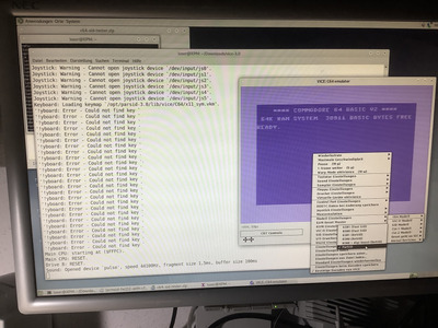

Reply 3 of 6, by matze79
Still no success with Vice, it only access parallelport one time during detection, then nothing anymore.
Parsid is selected, and its not playing over Soundcard..
No Action for CE/Adress Latch at all haha
i hoped i could avoid making a testing program, but it seems i will not.
768.58 KiB
319 views
745.72 KiB
319 views
https://shadowcircuit.de - german retro computer board
Reply 4 of 6, by matze79
https://youtu.be/eqFdJ_1xA7M
works.. First Tones !

Reply 6 of 6, by matze79
Trying to get Vice Build on djgpp, no success so far yet.
Its needed to modify the Auto Detection Routine.
There a lot of issues with DJGPP 😒, specially with building needed dependencies.
-> Detection Fine with ARMSID on LPTSID
-> Detection fails (often) with MOS6581
-> Plugging ArmSID first, then removing it and change it with MOS6581 Plug -> Vice plays just fine.
-> Adding Bus Driver -> also did not help with detection.
