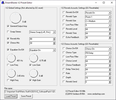

Reply 203 of 307, by badmojo
That comparison is well done, but doing a direct comparison is complicated by the EQ on the X2GS. The default settings didn't work for me, they made it sound a little blurry / over filter or something compared to the SC55 - same as this comparison. But after messing around with settings I'm happier with it.
Anyway, both sounds great to me 👍

Oh great, could you share your preset ? Maybe i can point pcsoundlegacy to it.

Sure thing! Disclaimer first, I don't really know what I'm doing and only used a handful of common game tracks to do my comparisons / tweaking (DOOM, Descent, Warcraft II, Dark Forces, etc). Attached is the preset I'm using and a s/s of the app. I would have liked to have softened the sound a little further, maybe with some filtering, but none of the settings on the right seem to have any effect?
The X2GS still sounds clearer and punchier than a real SC55 of course but I prefer it for what it's worth.
