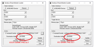

Hi,
here is some information on uploading presets for X2GS :
X2GS supports 2 presets, at the following locations :
- Address 0x70000 for User bank Preset
- Address 0x50000 for GS bank Preset
The X2UPLOAD tools will default to the user bank address (0x70000)
If you want to overwrite at the GS preset, change this to (0x50000) before pressing update
11.89 KiB
1674 views
You can find the original presets here : https://serdaco.com/downloads/?dir=X2/X2GS_Do … /DefaultPresets
in case you want to go back to the 'factory' sound.
