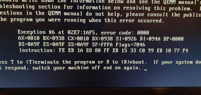

I couldn't resist making this tool just a little smarter. It now takes the extra steps of checking the current "context" of the chip (WSS or SB emulation mode), and making sure that volume levels are preserved and the context is the same before being returned to the command prompt. Depending on the hardware configuration stored in the EEPROM, the problem may not have been readily apparent, but it is definitely present.
Of course, I couldn't resist trying it...😁 But, it's obviously become too smart for this machine now:
136.46 KiB
747 views
Due to being much too late already, I haven't tested much, yet, but it's hanging with or without memory managers.
Reply 23 of 34, by 640K!enough
MJay99 wrote on 2022-04-05, 00:32:
I'm not quite sure how, but somewhere between the machine I use to develop these things (which is almost never on the local network, much less the Internet) and the machine I used to upload the file, it was corrupted. I have replaced the file, in ZIP format this time, so hopefully its integrity checks will alert you to a problem like this before you try running the executable.

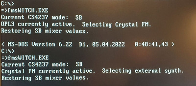

Reply 24 of 34, by MJay99
640K!enough wrote on 2022-04-05, 03:31:
It's working perfectly fine now, thank you again! 😀 I can instantly hear the different background noise floor when it switches to the CSFM.
99.65 KiB
710 views
Just one thing that came to my mind, since it's now (re-)setting SB mixer values: would it technically also be possible to maybe make it set a predefined volume difference to the original values while switching? E.g. realizing that the external FM in its default might be 50% louder in a certain card, one might think calling it with a percentage flag to reduce the volume accordingly right at the switch time (a static config file would probably be better, but I know it would add quite some overhead to this idea, so not even suggesting that).So, e.g. calling it something like this > fmswitch /opl2csfm=150
On a future version of this card, I might also try and reduce the level of the external OPL before it enters the CS, but it seems like a more flexible solution if it could be done in software.
Still, even without this, it's already more than I could have ever expected - so, a huge thank you!

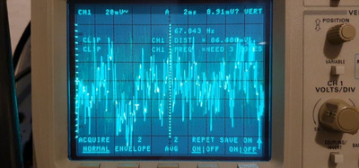

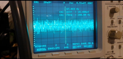

640K!enough wrote on 2022-04-07, 02:59:
Was this still apparent when you were switching between two EEPROM configurations (with IFM bit set/clear)? It could be a software problem, but could also be a separate design issue.

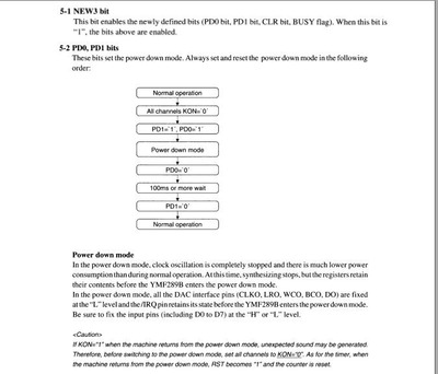

It definitly is and was. I've now played with it a little more (after having received another OPL for another test): so far, it looks like the OPL is always staying active when the IFM is selected and continuously providing MCLK and LCLK to the DAC. With these CLKs alive, but no data on the MDATA, the DAC seems to output a low level noise floor (so, actually in both configurations). With the OPL gone, the faint noise floor goes away, too (which I can do in my hardware setup, since the clocks for the YMF and CS are coming from the MK1420) - funny enough, this wouldn't be possible if I'd have clocked the CS from the YMF (as I am doing for the next planned version).
What's currently still not explained to me is: why does it suddenly get amplified immensely when the switch to the IFM happens and being reduced to almost inaudible levels when the external OPL is selected again (with no observable change on the DAC's Line-Out). Is this a to-be-expected behaviour of the CS4236 / CS4237B (which I both tried to rule out a defective IC, too)?
These are two shots from one of the AOUTs of the DAC, with the OPL3 playing and not playing (please ignore some of the displayed info, it's been the first time and even the first 30 minutes of using this oscilloscope):
84.92 KiB
635 views
78.81 KiB
635 views

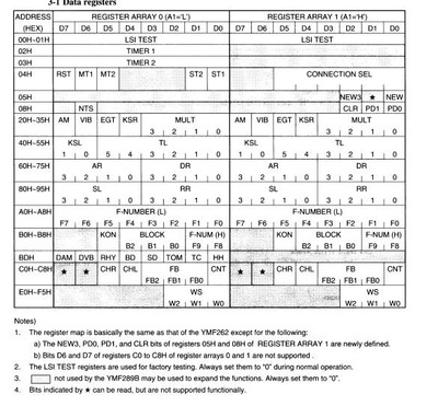

What I am wondering now is: would it be possible to use the YMF289's power-down feature to maybe try and silence this path when the IFM is on (since it only seems to happen with the OPL in place)?
The datasheet shows this:
58.04 KiB
635 views
87.9 KiB
635 views
What are the thoughts on this - easily doable and sounding reasonable, or pointless and hopeless? 😁

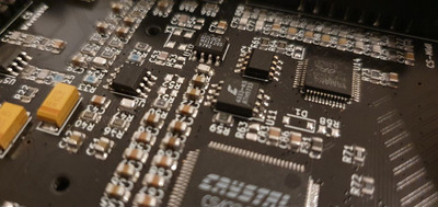

Reply 27 of 34, by MJay99
Well, this issue can be closed now, too. I actually had two things contributing to this: one being that during consolidating component values, I accidently left a double valued resistor around a TL082C I use for mixing two inputs together, therefore amplifying the signal 2:1 (though that was the minor issue and mostly just explaining the higher volume of the external OPL).
The more important one: I somehow overlooked that there should be some filtering between the DAC and the following stage, so adding that, it's pretty much perfect now.
All in all, I'm very happy with the possible solution, as the only real 'patch' it needs is a piggy-back cap on two resistors:
136.81 KiB
625 views
