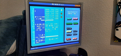

Reply 38 of 79, by sparky4
i found a bad bug in 1.00
load the modm from floppy from a directory not \ and swap it out and try to get it to load the new floppy's parent directory
hit up and down arrow keys and bam! glitches!
😁 this software is awesome keep it up! <3
    1.25 MiB
    952 views
    bug
wwww
Reply 39 of 79, by FreddyV
sparky4 wrote on 2022-07-19, 15:11:
i found a bad bug in 1.00 […]
Who still use floppy ? 😀
