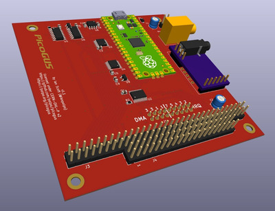

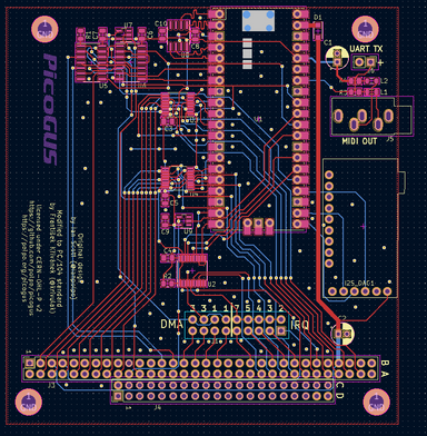

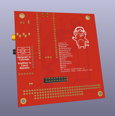

Hi,
yesterday I've got a PicoGUS PCB as a gift and because of that I became interested in this topic and then I thought - why not go PC/104?
What do you think? Can I make it? I am not sure about the license stuff... Kept everything the same, just added my name as a "modificator"

Edit: Forgot to mention - I know about the IRQ/DMA connector being wrong way - I had to mirror it since PC/104 interface is backwards from ISA and didn't feel like redrawing the whole connector. The same goes for the PC/104 interface, the only thing that matters is the hole pitch for the connector.
