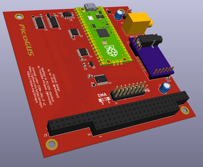

yesterday I've got a PicoGUS PCB as a gift and because of that I became interested in this topic and then I thought - why not go PC/104?
What do you think? Can I make it? I am not sure about the license stuff... Kept everything the same, just added my name as a "modificator"
Wow! This is so cool to see. It's so similar yet so different. You are free to modify my design! I've used the CERN OHL v2 Permissive license, which requires the work I've done to keep its license notice, but you are free to change anything else.
Reply 101 of 273, by krivulak
polpo wrote on 2022-10-31, 15:45:
Nice, so glad to hear that!
Today I modified the board a little bit more, found out that I missplaced the PC/104 connector, modified the DMA select header since the duplicate pins for DACK and DRQ were feeling a little bit off, and added blocking capacitor for the DAC, just for safety measures.

Reply 102 of 273, by MJay99
Just looking at the rendering I'm wondering if the line-out (and maybe other parts) are gonna fit between two PCBs (even more with maybe other parts mounted on the SBC it's probably gonna sit on). In the rendering it at least looks to be higher than the connector.

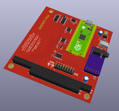

Reply 103 of 273, by krivulak
MJay99 wrote on 2022-10-31, 20:00:
Exactly my thoughts hence why I replaced it with more standard MIDI jack - 2,5mm. I was only too tired yesterday to design new device since there are no 2,5mm jacks in KiCAD library.

The highest thing on the board now is the pins for setting IRQ and DMA and standard height of those pins are 8,5mm tall and the specification for PC/104 allows up to 14mm with proper spacers or 9mm without spacers so it should clear it easily.

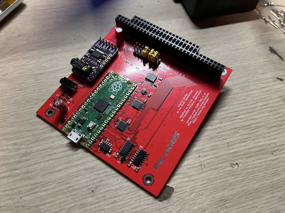

So... The prototype boards came and I assembled it. And I am quite happy!
491.55 KiB
466 views
I created a short video about the project so if you want, you can take a look at it and enjoy my happiness.
https://youtu.be/VZuFstWoktI
Hope Ian will write support for games since when this will be working, it would be the ultimate PC/104 card. Keep up the good work!

Thats really nice! I expect this not to work on a NuXT Turbo XT due to the 8 vs 16 bit bus? Or is the 16 bit bus on the PiGUS optional?
Reply 116 of 273, by krivulak
pan069 wrote on 2022-12-01, 08:58:
The card is 100% 8-bit, the 16-bit extension is just passthrough for another cards, so it will totally work in 8bit bus. As a matter of facts, I was debugging it in 8-bit mode using another connector as a riser.
