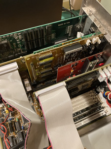

I finally built my own picogus and here is a summary of my experience of the build and use.
The main oddity i found is C9 and C10 are swapped from solder mask label and the online build guide. I went with the PCB labels.
Managed to drop 2 of the smd caps, found lost caps, tried the board didnt work, broke off side of cap trying to move it since it didnt look centered, replaced it with a generic ceramic through-hole cap of the same size, reflowed everything, then finally figured out i put the pico on flipped.
Once i flipped the pico in the right orientation it worked. Seems like a good design surviving my stupid mistakes 😉
Im running it in my main 486 system with the OPTi 82C895 chipset. Im sending the picogus into the line in of a diamond ALS100 soundcard.
The MB also has Am486dx4 100 mhz, 32 mb ram, 256 kb cache and VLB cards for vga and ide.
Ive run the card on freedos and msdos so far. I curious if i can get it running with windows 95, i dont have the init being called yet.
https://theretroweb.com/motherboards/s/edom-wintech-mv035
My main use is for the ultrasound music support and using the ALS100 for digital effects.
Ive tested doom, descent, jazz jackrabbit, omf, xcom, rott. I didnt find anything i couldnt get working yet.
I had only oddity occur where the ymf262 on the diamond card wasnt working at one point. I did get back with a combination of card pulling/power cycles. I couldnt reproduce losing it yet to determine it had something to with the picogus.
Thank you Ian for designing this and time you spent on it. I never had an ultrasound and likely never will. Having CMS/Tandy/MPU 401 is just icing on the cake.
Im excited what else we can add to this.
Also thank you so much for making it open source.

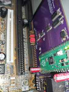

Hey guys, my picogus is running very nicely in a 433mhz Celeron (LX motherboard) but I'm totally confused about how to install the MIDI patches, I swear I've sat there 20 times and still not figured out how to get past the card detection and fail. The github says just skip it.. but.. I need mental help before I go insane :0

I need to improve the instructions for that as they’re mostly wrong because I went by memory. In the installer, choose the option to extract the files to C:\ULTRASND instead of going through setup. And then you can set the ULTRASND and ULTRADIR variables in your autoexec.bat file manually.

Thanks I got it to work, I went to the section called restore files and put *.*
I'm trying to get both it and a sound blaster working together now and make adlibtracker behave at the same time.. This is part of DOS I don't like to remember.
