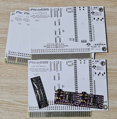

bazingaa wrote on 2023-06-07, 08:24:
just a quick question, can we use ESP-PSRAM64H instead of APS6404L-3SQR-SN , looks like pinout and specs are same.
https://www.espressif.com/sites/default/files … atasheet_en.pdf
Looks very similar. However you would need the H variant because of the 3.3V supply voltage. Both seem to use 1K pages and seem to work up to 133MHz.
Yes, the ESP-PSRAM64H is listed as an acceptable substitute in the BOM (see the notes column). There are several PSRAM chips that are functionally the same and they are all listed.

Just got PCBs from JLC PCB (USD 9 for 5 PCB including shipping) and SRAM, DAC from Aliexpress 😁 Gonna order other parts from Digikey and build it 😀
I plan to build one as GUS and other one as OPL. I think I don't need the SRAM to be soldered for the OPL one ? isn't it ?
