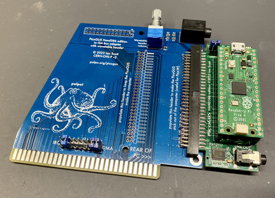

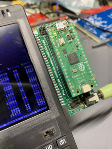

appiah4 wrote on 2023-07-12, 07:42:
Also, what is this Hand386 edition I am seeing on the interwebs 😁
I got a Hand386 and am pretty enthused by it. I've been having to be away from home for long periods of time to care for family members and missed being able to work on PicoGUS while away, and the Hand386 could be a nice highly portable platform to develop PicoGUS on. I was annoyed with having to deal with the ISA breakout on a ribbon cable to use a PicoGUS on the Hand386, and also its reset line is very noisy, causing spurious resets of the PicoGUS that make it unusable. I solved the reset issue by using the 74AHC logic family for U5 instead of 74LVC. Technically AHC is the "wrong" family to use because it's not TTL compatible but I specifically want the higher voltage threshold that it has to register a logic high. Since I had to make some hardware changes anyway and I was bored away from my workbench with lots of time to poke around on KiCad, I designed a version that plugs directly into the Hand386's ISA pin connector. I greatly miniaturized the PicoGUS board design to fit almost everything between the legs of the Pico, and I also integrated the DAC directly on the board instead of having to use the purple DAC module.
314.5 KiB
1686 views
224.56 KiB
1686 views
After teasing this design, I got to talking to some people and decided that it'd be a bit of a waste to have a PicoGUS that *only* works on a Hand386, so I set about making an adapter to allow it to plug into a regular ISA slot. Even more talking led to a few other features for this adapter. The first feature was to allow two positions for the Pico: the position first keeps the Pico fully within the PC, but the second allows the Pico to stick out. The second position is for two reasons: easy removal to swap over to a Hand386, and also for better WiFi signal when using a Pico W. With the help of yyzkevin, I hope we can get NE2000 card emulation working based on his PCMCIA projects. This will let you use WiFi on modern WPA2 networks easily on old PCs, as it just looks like an NE2000 card to DOS or old versions of Windows. The second feature for the ISA adapter is optional backfeeding of the audio and TTL MIDI back from the PicoGUS into unused pins on the Hand386 connector. This allows for a wavetable header on the ISA adapter, which can be mixed into the audio output of the PicoGUS. Also the Hand386 can be modded to play audio from the PicoGUS over its built-in speakers.
1.28 MiB
1686 views
I'm working on a video outlining everything about this side project that has turned out to be pretty cool. I've made a small batch of these and they're almost all spoken for, but I'll be making another run and putting them up on Tindie soon.
Also to help compatibility on the Hand386, I've fixed some issues with the GUS emulation that also improve compatibility in normal PCs. I'll be releasing new firmware with those changes (and other changes I haven't formally released yet, like better MPU-401 emulation and new CMS and Tandy emulation code from Aaron Giles)!
