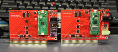

Reply 581 of 863, by polpo
PicoGUS hardware v1.2 is now released!
1.26 MiB
1689 views
Release notes:
A new release of the more DIY friendly version of PicoGUS "backporting" improvements from the v2.0 board.
  • Adds option for integrated DAC section. The purple "GY PCM5102" DAC modules have spotty QA, so integrating the DAC is both potentially lower cost and more reliable. Footprints remain to still allow use of the DAC module.
  • Reset stability improvements: RC circuit on Pico RUN pin to delay start on power up and filter out glitches on ISA reset, and U5 is now 74AHC logic family for higher positive-going threshold
  • ISA RESET has weak pulldown to allow reliable programming the Pico outside of powered PC
  • DACK has weak pullup to allow PicoGUS to be used without DMA channel set
  • 5V MIDI circuit: uses open drain inverter for better drive and uses more commonly available resistors
  • U2 is now specified as an 74LVC244 in the BOM: it's cheaper and more available and in my testing performs just as well as the 74CB3T3245
  • Jumper to apply power to micro USB-B connector on Pico to allow USB HID devices to be used
  • Fixes to card dimensions to better follow ISA card specs: narrower card edge and better fit for card bracket in PC cases
  • Production files for JLCPCB full PCB assembly
  • Updates to thank you section on back
Gerbers and JLCPCB PCBA production files are available in the release at https://github.com/polpo/picogus/releases/tag/hw_v1.2. I'll be updating the build guide and Mouser and Digikey cards for the new release in the coming days.

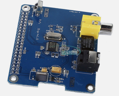

Instead of the PCM5102 DAC, could a WM8804 S/PDIF transceiver chip (or something similar) be wired to Pico's i2s to get digital output and would that work with PicoGUS? Picture attached of a PI hat with WM8804 chip.

Reply 584 of 863, by appiah4
janih wrote on 2023-12-14, 08:22:
Instead of the PCM5102 DAC, could a WM8804 S/PDIF transceiver chip (or something similar) be wired to Pico's i2s to get digital output and would that work with PicoGUS? Picture attached of a PI hat with similar chip.
Ooh, I'm all for using something like this as a breakout board, maybe connected to the PicoGUS with a ribbon cable, to provide optional SPDIF out 😁
Reply 585 of 863, by rasz_pl
no need, rp2060 can do spdif in/out in software, only 1 gpio required.

Reply 586 of 863, by janih
rasz_pl wrote on 2023-12-14, 11:25:
no need, rp2060 can do spdif in/out in software, only 1 gpio required. out https://github.com/mill1000/raspdif in https://github […]
in https://github.com/elehobica/pico_spdif_rx
Nice, so based on the "raspdif" repo for spdif output, I need to connect SPDIF port to GPIO21 (or GPIO31) and make some ALSA configuration to output audio to it. Would this work in a seamless manner with PicoGUS?

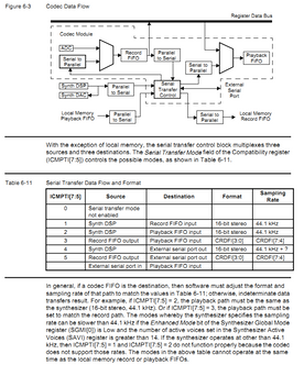

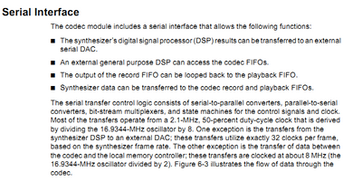

jmarsh wrote on 2023-12-14, 18:24:
Only the original GUS (GF1) reduced the output sample rate when more channels were enabled. The AMD Interwave (used on the Orpheus) still uses the lowered rate for input but then resamples to the fixed output rate.
if I am reading the OrpheusII page correctly, the Interwave chip analog output is hooked to CS4237 Synth input, and the Crystal chip is responsible for S/PDIF output.
The Interware IC also supports routing wavetable synth data to the serial audio output port, with support of rates lower than 44100 Hz in GUS compatible modes:
73.78 KiB
1305 views
144.88 KiB
1305 views

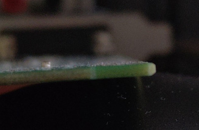

While I'm eagerly waiting for restocking it's "nitpicking Sunday" 😀 time for me.
Q: polpo, is PicoGUS isa connector edge rounding/shaving (my English's failing on me here) oversight or cost cutting measure?
Asking because other modern replica isa cards like Blasterboard and Orpheus have it(attached pic) so PCB houses are able to do it...

Reply 599 of 863, by polpo
vutt wrote on 2023-12-17, 10:29:
The common term is edge chamfering or beveling. It was an oversight in my original design. In the PicoGUS v1.1 and v1.1.1 design, the distance from the edge of the board to the "fingers" is 0.2mm. The card edge design was inherited from another open source ISA card project. This distance is too short for most PCB houses to reliably do chamfering (for example here are JLCPCB's guidelines). Sometimes they can do it at that distance, sometimes they can't, or sometimes they will edit the design for you if you specify you want chamfering. To fix this, starting with the PicoGUS Femto ISA adapter, PicoGUS v1.2 and v2.0, I've been using a larger distance for the fingers so the PCB houses can do chamfering reliably. All PicoGUS boards I've sold personally have chamfered edge connectors.
Edit: one thing to note is that chamfering is not part of the PCB design and is something you have to specify in the options when placing the PCB order.
