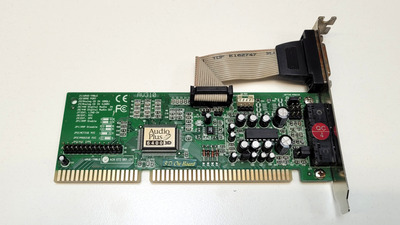

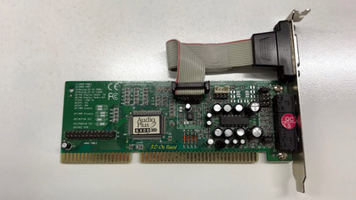

Reply 17 of 26, by dionb
appiah4 wrote on 2022-07-04, 09:09:
CMI8330's 3D spatial effects are really lacklustre.
I do believe some ESS cards can do this; if you can find one with an ES688/ES1688 + OPL3 and the ES968 effect chip all on one card you are golden.
The potentially interesting bit is that early revisions od the AV310 card have an early 8330 rev A without integrated 3D stuff and instead use a discrete chip (tiny thing, haven't identified it). That might sound different to the integrated 8330 rev C. Still, I recal you have a card with the A-rev and external chip and weren't impressed either.
Reply 18 of 26, by appiah4
Joseph_Joestar wrote on 2022-07-04, 09:36:
IIRC, the 1688 cards only come with ESFM, while 688 cards can have OPL3 chips.
ES1688 does indeed have an integrated ESFM synthesizer but it can also be connected to an external genuine OPL3; such cards are rare but do exist. Theoretically there could also be ones with an external OPL3 as well as an ES963 athough I never saw one..
dionb wrote on 2022-07-04, 10:29:
I have these two cards, and they do have a tiny C8300 chip that I believe may be the spatializer.. That said, no it does not sound good 😀

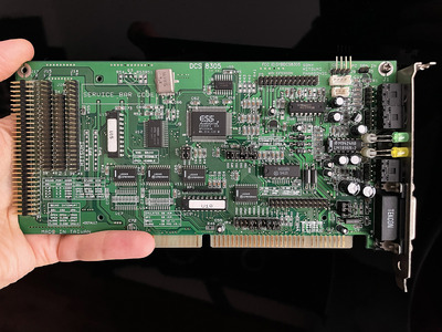

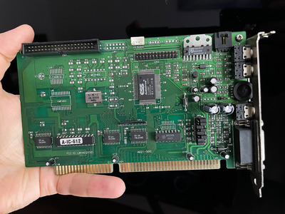

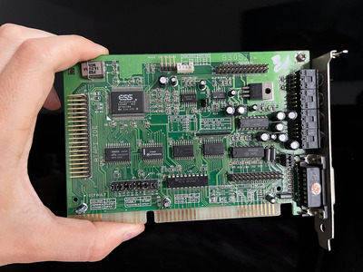

Reply 19 of 26, by bloodem
Yeah, I've never actually seen an ES1688 with a usable dedicated OPL3 chip. Even if there are some, they're probably unicorns. Either way, they're all amazing cards (especially the non-PnP versions). Not that I'm bothered by PnP, but based on my experience, most of these later ESS PnP models seem to be more cheaply built (and as such, sound quality takes a considerable hit).
I have the following cards, and not only do they sound great (especially after replacing a few capacitors), but they are probably some of the most compatible cards that I have.
I think the ES1688 is my favorite (the fact that it has ESFM instead of OPL3 does not bother me at all). This one has the richest sound, deep bass, low noise and it's definitely the least speed sensitive. I have two of them and they're usually my go-to cards whenever I test any system that has ISA slots. Also, it actually has pads for an YMF262 chip + the YAC512 DAC, but I'm unsure if these were ever meant to work with the ES1688, or if it's just a reused PCB design from an earlier 688 model.
