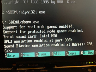

Reply 85 of 405, by Bondi
Did some quick testing and the results are impressing.
Wolf3D, Rott, Prince of Persia - work fine both FM and PCM. Duke3D works amazingly!
GTA1 - works mostly fine, just very slight stuttering sometimes.
DOOM I/II - Music is fine. Digital works, but very distorted. Recording attached.
New Recording.m4a
240.94 KiB
8 downloads
MDK - hangs in the menu.
LBA - setup won't start.
Chasm the rift - game didn't start.
Tested on Thinkpad x60s with Intel HD Audio AD1981HD.
59.76 KiB
470 views
Will try more games later on.

Reply 87 of 405, by Bondi
DOOM works perfectly now. Which means a bunch of games that use same engine.
Also tried Tomb Raider and HOMM2 - all woks.
Quake - no sound with the first version, and doesn't start at all with the later.
EDIT: Darkforces and Tertis Classic work fine.
