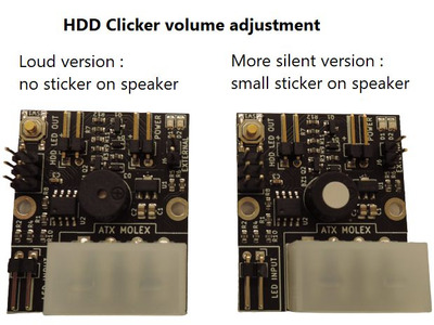

Reply 73 of 104, by dreamblaster
oh cool.
All clickers are shipped now, I'm curious to hear your feedback.
especially regarding volume/tone control : minor mechanical changes have huge impact on the sound
the 2 extremes are selectable as options :
50.5 KiB
1216 views
But there is much in between, just pierce a small hole in the sticker, and slowly enlarge it :
you can quite accurately control the volume this way.

oh cool.
I started reading this post thinking there would be a jumper added or a resistor that needs to be shifted from one pair of pads to the other, but no, it's a sticker. I'm laughing out loud and everyone at the office thinks I've gone crazy, and it's your fault Serge 🤣
haha 😀
i updated the descriptions, and made 2 options available now :
- Quiet rounded tone - IDE HDD sound (sticker on buzzer) --- THIS IS THE NEW DEFAULT CHOICE
- Loud and noisy - Quantum HDD sound (no sticker on buzzer)
The physical difference is small (only a tiny sticker), but the sound difference is huge !
It sure is worth experimenting until you get it right to your taste.

I made a quick video to show what the test button does, and the sound difference when placing a small sticker :
When built into a pc case, the conclusion may be different, but out in the open, I personally prefer the more gentle sound with sticker.
What do you think ?

I was excited to find my HDD Clicker in the mail today. Installation only took 5 minutes. The 3D printed case (made from the STLs) fit perfectly. And I love the clicking! 😁
The "sticker" mod feels like the right way to go. Afterward, the sound is very authentic and nostalgic without being obtrusive. Defragging is more fun again, hehe.
