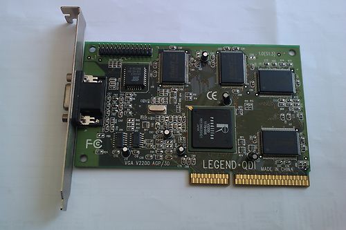

felt sure if i mentioned it I'd meet the competion here on Vogons:) only 4 bids though. I'd heard of the 4mb QDi on these pages so thought it was worth a gamble. The Hercules might attract a lot more attention.. we'll see if it holds it's own..
EDIT: here's a pic.
    29.04 KiB
    2532 views
