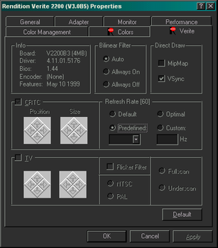

I wanted to ask Verite V2200 owners what driver version they are commonly using? In terms of features, performance, reliability, and compatibility (older Speedy3D and early versions of the RRedline API) is there a specific driver version that covers all?
I've recently been playing with both the Hercules Thriller 3D driver and the Rendition reference v3.0 beta5 drivers on my QDI Legend AGP. Although I do find varying results from these drivers on my different Verite cards (PCI and AGP), I found that the v3.0 beta 5 seems to offer more features (Alpha Blending in WizMark, hardware recognition in Final Reality), improved stability (less crashing in vQuake) and better OpenGL performance (faster frames in Quake II and exponentially better scores in 3DMark99 MAX).
One drawback I did notice is that the v3.o beta 5 display settings applet does not retain any changes made. For example, I can disable vsync and when saving, exiting and going back to the applet, I can see the change is retained. However, once I reboot, the changes are lost (vsync is re-enabled).

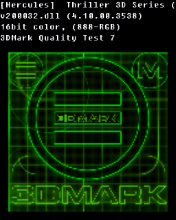

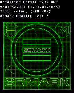

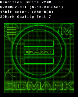

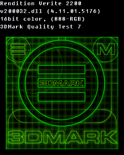

I agree with swaaye. Originally I have used the last one released by Hercules (Version 0.85.3596 / TH3DW085.EXE / 1998-Apr-04). But I have used the card primarily for Direct3D and the v3.0 beta5 driver is much faster and have much better picture quality in Direct3D so I have switched to the v3.0 beta5 driver.
Later I have tested the released and beta versions from the SDK package but the released version is the same ugly as the Hercules one, and the beta version have big problems in D3D so this is the worst one. Now I have tested in D3D the v3.0 beta3 and D3D picture quality looks the same as beta5.
So I think for usually the v3.0 beta5 driver is the best. If you find problems with RRedline you should try an older one (TH3DW085.EXE or "released" driver from the SDK package).
Here are the picture quality images:

Wow! That image quality is a big difference. It was something I wasn't even aware of. I'll check that out in my 3DMark and 3D Winbench image quality results, as I've already ran benchmarks for both the Hercules driver and v3.0 beta5.

That test is checking for texture size support beyond 256x256. A Voodoo3 would look bad too for example but it doesn't really matter for the games you'll play on the card. It's cool that Rendition was able to increase the limit though.
Reply 469 of 583, by Gona
So it can exist that the driver has bad image quality in resolution 256x256 but good in 640x480?

Reply 470 of 583, by swaaye
Sure. 256x256 is far beyond texture dimensions in N64 games and there are some N64 games that are render at or near 640x480. 😀 N64 developers also demonstrated ways to work around such limitations.
It's interesting that V2200 was initially limited but it wasn't a hardware limit.

Intreresting. Why they put 256x256 testing into the 3DMark?
Back in 1999 the industry was getting ready for textures of higher resolution. Voodoo3 notably did not, and caught some criticism for that.
It is likely 3DMark wanted to make very obvious demonstration how features can affect image quality. Although high res textures were still quite futuristic.
Aren't you confusing texture resolution with display resolution?
Reply 473 of 583, by Gona
Putas wrote on 2020-05-29, 05:21:
Thank you. Yes, I have confused the texture resolution and the display resolution. I have thought that 256x256 what a small, but now, what a big! 😀
