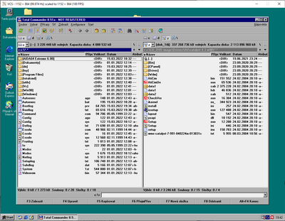

I am running Datapath VisionAV capture with the VCS software and I just can't get proper colors. Everything is too dark. For instance in this screenshot the white color is rgb(239, 239, 239) instead of (255, 255, 255) and the blue widow bar is (0, 0, 112) instead of (0, 0, 128). With the original Datapath SW it is the same.
63.87 KiB
2423 views
In this case I am running Radeon 8500 and using DVI connection. With VGA it is even worse...
I guess I could calibrate it somehow, but I feel something else is wrong here. Any idea what could be the cause?
Thanks 😀

You should be able to adjust the contrast and brightness globally and per color channel. My VisionRGB-PRO has the same color balance issue, but you can balance it manually and get it perfect enough.
Reply 1166 of 1307, by havli
Thank you. It works, now I have calibration for all my resolutions stored in a file and colors look very well.
