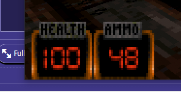

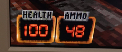

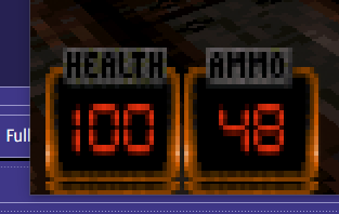

Reply 1274 of 1403, by Kordanor
Can anyone who is using a Datapath VisionRGB check whether or not 640x480 gives you a complete picture? I was just setting up profiles and noted that no matter what, 640x480 is always missing a few pixels at the bottom. You can move the screen up, but it doesnt give you the missing pixels.
It's quite noticable in Duke Nukem 3D when you look at the health and ammo display which should have a few pixels below that.
This does not happen on 800x600 btw, only on 640x480. Tried on 2 different machines/graphics cards.
Also its not a VCS issue as it also happens with original drivers.
So either this is a generall issue with VisionRGB or one with my particular model

Reply 1276 of 1403, by Great Hierophant
The Datapath has a known bug in that at 640x480 @ 59.94Hz it will not display the bottom 2-3 lines correctly. The solution that worked for me was to set the refresh rate to 75Hz in Windows. Obviously that will not work in pure DOS but I am sure there is some solution which allows you to change the refresh rate, maybe to 70Hz.

Reply 1278 of 1403, by Kordanor
Great Hierophant wrote on 2023-02-28, 23:40:
That phase issue looks like the horizontal size is not being dialed in correctly, leading to sampling errors which the phase control cannot fix. I believe the correct horizontal size should be 800, not 797.
Thanks for the phase thing. That fixed it 😀
Regarding the Check on Windows, I will need to test. Had no windows installed so far, and no graphics drivers...and no CD drive...so...will take a bit ^^
