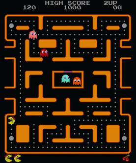

So, discovering the Datapath card may not be as ideal as some think for DOS capture. Tried using JROK's "Ms. PacPC" in fullscreen mode, and a total of 20% of the image for top and bottom are completely cut off. Looks fine on the Datapath via OSSC.
Though (as with amy 4:3 source), my EVGA XR1 Pro always seems to stretch the image to 16:9.

Reply 1374 of 1376, by vvbee
NightSprinter wrote on Yesterday, 14:33:
There isn't just one Datapath card. The VisionRGB-PRO captures the full board, though at least with this Matrox G400 reports the resolution as 772 x 579 and lots of empty space on the sides which I cropped out:

Reply 1376 of 1376, by NightSprinter
vvbee wrote on Today, 06:00:
I have the E2S, and it only sees the fullscreen mode as 640x480 59.94Hz. Hence the screenshot I provided.
