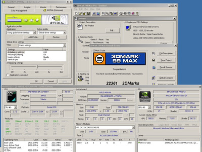

Reply 303 of 312, by Meatball
3DMark '99 - Geforce7 7950GT on Windows ME. It’s CPU bottlenecked around 24600 3DMarks all the up to 1600x1200, 32bit color, 24bit Z-Buffer. Bumping AA to 2xQ on these settings finally has the card doing some work as shown, but not much more. 22361.

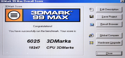

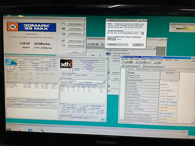

Reply 306 of 312, by sirotkaslo
Another go with the V5 5500@190Mhz, C2D E7500 got 13436 3dmarks

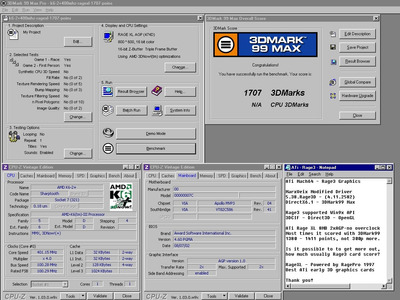

Reply 308 of 312, by marxveix
Usually i score with that K6-2+RageXL machine from 1380 up to 1411 points if i overclock cpu from 400 to 500MHz. I think it is possible to get 20 more points without any overlock for that system, my next goal is 1400 points with Rage3. Still i have 1707 points score also for that ATi Rage XL. 😀
file.php?mode=view&id=169742
