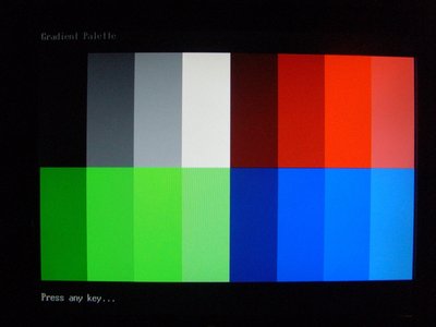

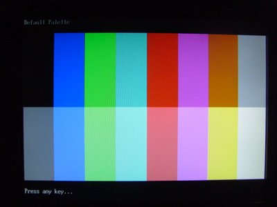

Here is a simple color test program I made, along with screenshots from my LCD with the converter. The colors look the same on my CRT. (The top pic looks a little washed out, but that's just my camera.)
    egacolor.exe
    20.08 KiB
    77 downloads

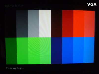

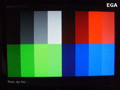

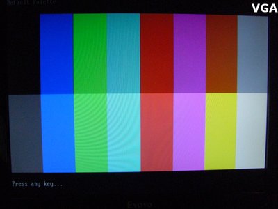

Reply 66 of 341, by Plasma
Hmm well you shouldn't be using my pictures as an absolute reference. They obviously aren't proper VGA captures just pictures of my monitor, and the exposure of the camera isn't constant. I thought the colors looked ok on mine before but I updated with the latest code. To be honest I don't notice a difference (the OSD is nice though). But I took some more screenshots with both EGA through the converter and VGA directly to the monitor. It looks pretty close to me.

Reply 68 of 341, by retrocanada76
I have a 286 VGA to use here as reference. I will try it as I don't use it.
If you look to the code, I am not propagating the bits to bits 0 and 1. I think this is much closer to what should be. In essence the normal should be half bright as the brighter ones. That wasn't the case.
The OSD is not the only difference. You have much more freedom to adjust the screen, before it was 16 pixels only, now is 127px
