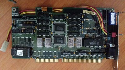

I am attempting to restore an old portable LCD-386, which looks basically the same as this one.
I'm not able to properly test the LCD because the video card isn't working. It's a Cirrus Logic CL-GD610/620 based card with 256kB, and since it would prove almost impossible to find a replacement, I would like to repair it if I can. Here's a pic:
225.08 KiB
2301 views
On startup I get BIOS error beeps - 1 long and 3 short, indicating a video card failure. The computer does boot, albeit with no display, so I was able to use debug.exe to get a copy of the ROM. The ROM description is:
Stingray Rev 4+, VGA BIOS Version 2.22
Copyright (c) Cirrus Logic Inc. 1989, 1990.
Copyright (c) Award Software Inc. 1984-1988. All Rights Reserved.
The 8-bit checksum is 0. The 16-bit checksum is non-zero, however I've seen other ROMs with a non-zero 16-bit checksum, so I'm not sure which one is used or whether the 16-bit checksum value is also stored in the ROM. Thus my ROM seems to be ok but I can't be 100% sure. I did however download a copy of the GD610/620 BIOS from Vlask's VGA museum site (thanks again Vlask!) and got an EEPROM burnt with that, just to see if it would work. No luck - but the error is slightly different. I still get 1 long and 3 short beeps but now they are much longer.
With the original ROM it's like this: Beeeeeep bip bip bip
With the ROM from Vlask's card: Beeeeeeeeeeeeeeeeeep beeeeep beeeeep beeeeep
I'm not sure how significant that is. By the way I have also tested the card in a 486 and 6x86 with the same symptoms (they all have AMI/Award BIOSes).
So... does anyone have any suggestions, or experience fixing old video cards? There are no broken traces I can find or burnt spots or any other obvious visual clues. The RAMDAC is probably the easiest thing to replace, followed by the memory chips. However with those I'd have thought the card would still POST but just have a blank or garbled display. Oscillators perhaps? Those are all within my soldering skills, but replacing the chipset would be beyond me.

The card has 8 dip switches (external), and one 3 pin jumper, marked JP1. In the pic you can see it just near the yellow wire to the left of the switch block. Removing the jumper or moving it to the other 2 pins has no effect, nor does trying the card in an 8-bit slot (and again trying the jumper in case it's for 8 vs 16-bit selection).
I can't find anything about this card online (stason.org etc) but I have tried a few switch settings based on possible similar cards. Nothing makes a difference - but then, I would not expect it to. IMHO it would be a poorly designed card that could be easily "broken" via externally changeable switches.

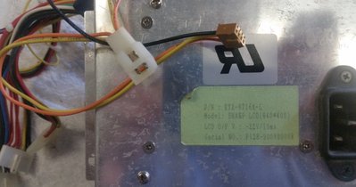

The toggle switch and yellow/red wires are for turning the LCD on or off. That connector goes to one on the PSU which I think is meant to supply +12 and -22V - the toggle switch controls whether it's sent through to the brown connector at the top of the video card. (See pic of PSU connectors below).
The PSU doesn't work either, but by connecting gnd and 12V to the right pins on the video card, I was able to at least power on the LCD panel and see that the backlight is working.

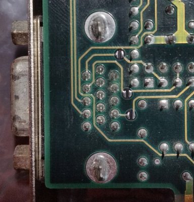

The only visibly unusual thing about the PCB is where 3 VGA connector junction points appear to have been left deliberately unsoldered, as you can see here:
57.94 KiB
2215 views
I checked and sure enough, they are for the monitor ID pins (4, 11 and 12). I guess this makes sense as the switch block is probably used to specify the monitor type so that the card would still work (with the built in LCD panel) without an external monitor connected.
Thus perhaps if there was a problem with the switches or the resistor packs then the computer isn't seeing that a monitor is connected and hence the error beeps. Theoretically pin 11 to ground would indicator a colour monitor not supporting 1024x768, so I tried carefully shorting the solder point for pin 11, but no luck. I also tried it with the LCD ribbon cable connected in case the card needs to see the LCD panel, but again, no difference.
I found this post suggesting possible switch settings but had no luck using that as a basis for more testing. I could sit down and go through all 256 combinations of the switches (768 if you include the 3 possible jumper positions!) but I have a feeling that wouldn't make a difference either.

Check the tantalum capacitors for shorts. These aren't the small bead-like yellow ones (those are ceramic caps), but the larger\taller yellow capacitors. I can see three: One near the ROM, and two near the VGA port.
As old as that card is, this is what I would lean toward.
In a pinch I've replaced these with a standard aluminum electrolytic cap of the same values to get an old video card working and I can't say I've ever noticed any problems. Granted, the best replacement would be another tantalum or at least a good quality low-esr modern capacitor.

Reply 19 of 30, by Jonas-fr
Thanks for your feedback. Seeing how the ramdac (Suntac GS02760-50) is socketed should give us a hint that maybe this was a problematic chip that would have to be replaced when RMA'ed.
If I were you I'd start by replacing this chip !
