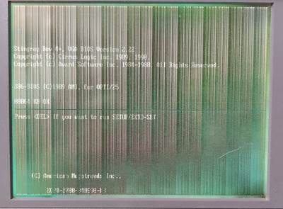

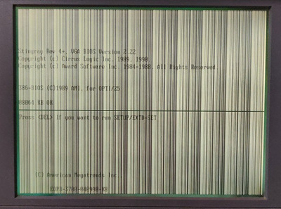

Reply 28 of 30, by InbetweenDays
incanus wrote on 2021-02-01, 18:44:

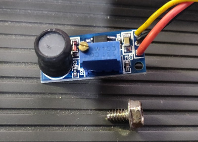

Awesome, really glad to hear it @InbetweenDays! I'm curious how your recreation of the -22V PSU goes as that's a weak point of my setup (or any of these) as far as bizarre, unique parts goes.
Easy done... grab yourself one of these from eBay: "MC34063A Reverse Voltage Module Positive To Negative Voltage Converter". I just got mine today and it works perfectly to get the -22V
So now my LCD is, well, let's say operational at least. Pics below... anyone know if this is fixable? I guess it works well enough to see what I'm doing to switch to an external display... 😒
By the way the module is a lot smaller than I expected - pictured here on top of the portable, next to a standard #6-32 UNC case screw.

Reply 29 of 30, by Ozzuneoj
InbetweenDays wrote on 2021-02-12, 06:30:
Easy done... grab yourself one of these from eBay: "MC34063A Reverse Voltage Module Positive To Negative Voltage Converter". I j […]
This has really come along nicely! Great job!
As for the visual corruption, I'd use my super scientific method: Poke every video related component or connection with something non-conductive to check for any bad physical connections or broken solder joints. I have had video cards clearly respond to physical prodding while they were displaying artifacts\lines on the screen. This can take some of guess work out of the diagnoses. Though if you see the corruption getting worse and worse, it may be best to not power it on again. Also, if there are any jumpers involved, make sure they are tight and not oxidized. Lastly, it could be capacitor related, but without seeing the LCD components it's hard to say.
Reply 30 of 30, by InbetweenDays
The new RAM chips fixed the corruption - well, the vertical lines at least. It's interesting that the dodgy ones work fine with an external display, with no visible artifacts.
The only thing left is that dark horizontal line through the middle of the LCD, which I'm assuming to be a problem with the panel itself. I'll eventually rip it open and see if I can clean any contacts etc.
