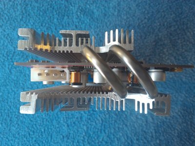

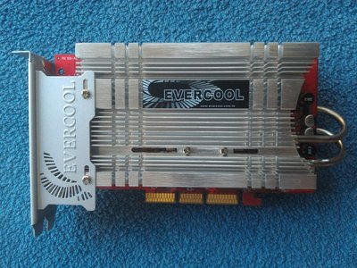

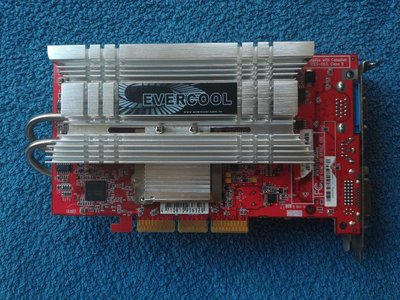

Reply 19 of 20, by Radical Vision
When i did search back in the days for cooler like that i did found 2 coolers, that zalman here on the pictures, and other one that seems better and more masive.
Evercool VC-RHA - passive
Evercool VC-RHB - fans
I have the fan version, everyone knows evercool to be junk brand, but that cooler seems to be very nice, and to cool the old cards properly, and even have x2 heatpipes.
Now the fans are junk they die, so you can use just the heatsink, with other better fans. I did use that cooler to cool the stove ATi FireGL x3 and it did really good job..
