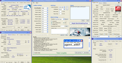

RaverX wrote:
Crysis might "work" on 9800XT, but I'm sure it doesn't work "fine" 😀
When Crysis was launched I had a 6800 Ultra and it ran like crap on that card. And 6800 Ultra is much faster than 9800XT (in some games in high resolution even more than twice the performance of 9800XT).
315.3 KiB
432 views
With 1024x768 Icy/Frosty levels MAY be possible (kinda hard to tell, since I actually tested jungle only).
GeForce 6000/7000 series aren't good match for Crysis.

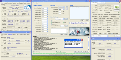

302.29 KiB
432 views

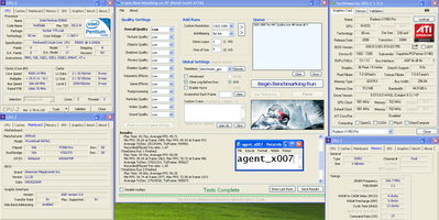

X850 XT PE for comparison :
339.86 KiB
432 views

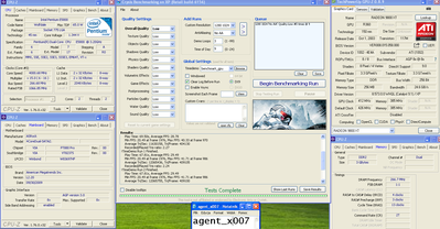

Radeon X1000 series is A LOT better.
303.13 KiB
431 views
