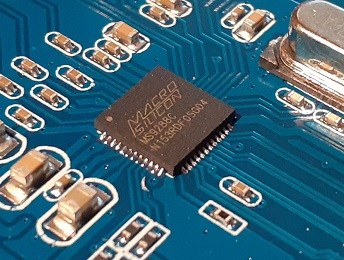

For those that have a AIXXCO adapter working at 720x400@70, can you please open it up and check the IC inside? I think they've """upgraded""" it and it's now using a MacroSilicon MS9288C instead, which doesn't seem to be capable of handling it.

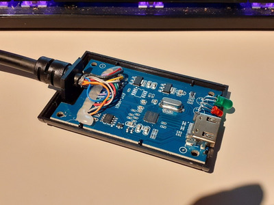

Mine has an IC with a marking written 'AG02-EX' inside. I've found someone's blog online about that MacroSilicon not working with older modes, unfortunately. There's only specs I could find about it, not even a datasheet. Maybe the I2C EEPROM is missing some EDID data. Someone with an EEPROM reader or hooking it up to an arduino could dump it's contents and investigate.
Mine is also AG02-EX (it says 2103 under that, which I can only tell from having taken a photo of it and zoomed in 😀 )
The first cheap adapter I tried also had an MS9288C, and it also didn't work with 720x400@70Hz.
It would be sad if the only cheap working option out there is no longer available!

christal87 wrote on 2022-10-06, 15:19:
doshea wrote on 2022-10-07, 22:37:
Mine was bought in March 31st, 2022. I guess you bought yours earlier than that?
Reply 255 of 323, by christal87
socram8888 wrote on 2022-10-17, 08:45:
I bough mine on July 2nd, 2021 and the order history points to this item now on aliexpress (which looks exacly the same on the outside at least):

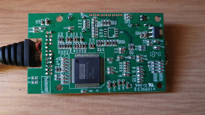

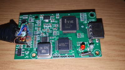

Reply 256 of 323, by agent_x007
Pictures of my Delock 62408 : https://www.delock.de/produkt/62408/pdf.html?sprache=en
606.72 KiB
684 views
562.66 KiB
684 views
Video IC used : LINK
Spec sheet for it : LINK
Can do 1280 x 1024 at 75Hz (rated speed).
I tried it under Windows XP, and it can do up to 1280x720 @ 85Hz (720p being max. vertical resolution for this mode, but 1024x768 @ 85Hz also works). 85Hz+ isn't possible.
