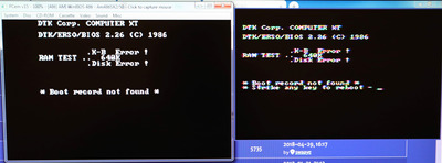

I recently bought this China (6€!) logic analyzer. It can capture signals with 24 MHz on 8 channels! Software available for free here:

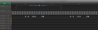

I was really surprised after connecting to my CGA how accurate the signal is. Below screenshot shows:
Channel 0 VSYNC
Channel 1 HSYNC
Channel 2 One color Channel
99.89 KiB
3780 views

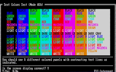

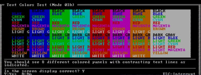

Even if 24MHz might not sound sufficient I started with a 320x200 startup screen and tried to reconstruct the image from the saleae capture file with a simple QBASIC-Program. Thats what I get
16.64 KiB
3780 views
For this picture only every 2nd Pixel (and one color channel) on the x-axis was used - so much potential left for this resolution.
Compared with cinch-out:

Has this been done before..? I think this has a fantastic potential when looking at this:
EGA/CGA capture with High-Speed Digital I/O Card
This is far beyond my skills...but if it is possible to capture the data directly from the USB-device it would be a very simple and cheap way to connect a EGA card to a modern PC...?
I will try to further improve my program to see how it can look like at 640x480x16.

Reply 2 of 212, by Predator99
As said, real time capture is beyong my skills...would be very happy if somebody could try this. But it seems to be possible to get the data from USB in realtime.
https://learn.sparkfun.com/tutorials/using-th … k-pulseview/all

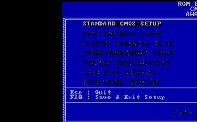

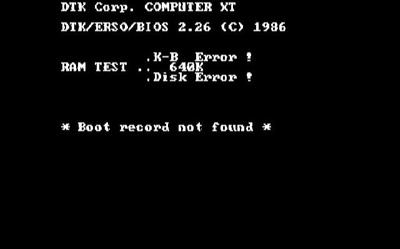

Below screenshot is from a BIOS Setup screen (CGA80) using the 3 RGB channels. It is not scaled to fit on the screen and shows all data captured (right part is not displayed). CGA output is 640 pixels per line. In the capture file I get 1529 bits from it for each channel. This should be enough data to remove that jitter effect which is still visible. 640 pixels is the maximum CGA/EGA resolution so this 6€ device has enough power to make a perfect capture als from 640x480x16 EGA...

Quite surprised nobody seems to be interested. This has the potential to replace a MCE2VGA or GBS8200 for just 6€..? Its also a big benefit the output can be displayed in a window on your Desktop.
I recalculated and you have 1071 samples for a 640 pixel line. So every pixel is captured, most of them twice. Below picture combines all data (CGA).

Good news, there may be a possibility to get this running in real time with my rather limited Windows-Programming skills:
The device works with above mentioned "sigrok" which has a CLI which can output the captured data on the stdout:
"C:\Program Files (x86)\sigrok\sigrok-cli\sigrok-cli.exe" -d fx2l afw --continuous -O hex

I also managed to transfer my DOS-QBasic-Program I made above screenshots with to Windows 7 (QB64).
Therefore I should be able to combine both (redirect sigrok output to qb64-Program via ">") and it should be running in "live" mode.
Currently everything much too slow...it takes some seconds to draw a single image from a csv file. But this can be improved by using a hex-format for data-transfer and my program is currently not designed for speed...
So if anybody has c# programming skills you are invited to support...I am afraid qb64 will be too slow at all for 25fps. But I will try 😉
