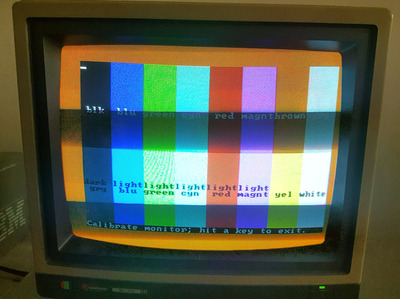

It doesn't give the best picture I could hope for - there's hardly a difference between red and brown (colors #4 and #6). And dark grey (#8) is just missing - it's completely black regardless of any brightness/contrast knob twiddling.

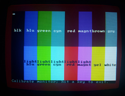

But the main problem is a deficiency in uh, stamina. When you power it up, the image looks alright at first:
263.96 KiB
691 views
However, pretty quickly you start noticing that the RED component is fading away, and some of the brightness with it.

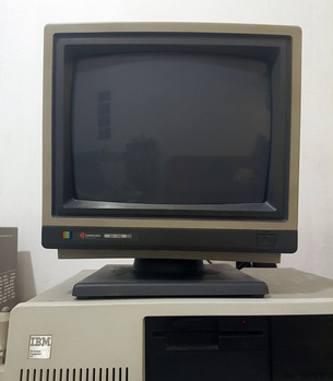

Here's what the above screen looks like after three minutes... it only goes south from there:

It is not uncommon for older monitors to have a warm-up time: some start with low brightness and stabilize after a couple of mins some do the opposite and start with high brightness.
I would not not go replacing caps just yet - these tend to fix geometry issues not color ones.
What I would do is allow the stabilization time and re-adjust the R G B pots on the neckboard (these adjust the intensity of each color) and also locate and adjust the contrast/brightness knobs.
It might also be needed to adjust the SCREEN pot that is usually located on the LOPT (the thing that has that suction cup that end up to the tube) this adjust how bright the screen is in simple words.
So if after those adjustments you still can't get a descent picture it could mean that the screen has worked countless hours and can't really show anything better.
If you get a good image and you can do it yourself then also do some electrolytic recaping, it won't hurt but first mess with the knobs and pots and see what you get

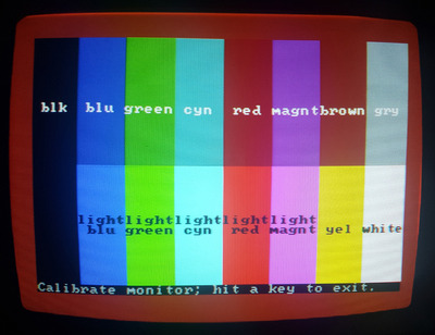

A little news - very little, since I haven't had much time to mess with this. I'm not thrilled about performing invasive procedures, due to the local unobtainium status of these monitors... and in any case, we're in the middle of another lockdown, so no there's no getting parts/tools for another week or two.
But it turns out that this monitor CAN produce some decent browns and dark greys if you put a gun to its head. 😉 I did some deliberately rough manhandling of the brightness knob, thinking that the contacts may just be dirty, and now I can actually get the following colors (for a frame or two until the contacts start sucking again):
162.92 KiB
480 views
A bit of deoxit or such might take care of the contacts. But the fading red issue will probably need some deeper treatment.
