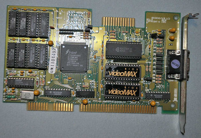

Hello, I am trying to set up a TVGA 8900c VGA card in Windows 3.11. It has 1 MB Ram and it should support 1024x768 in 16 and 256 colors. But the most I am getting out is 800x600 in 256 colors or 1024x768 in 16 strange colors (what should be black is pink). Also 800x600 in 32k or 65k is not working, here I get a strange black&white desktop (progman, etc.) with noisy pink backround. If I choose 1024x768x256 resolution in Windows Setup, I get just black screen or error message (it disapperars too fast to read it) when starting Windows, but then Windows still runs, I can end it and return to DOS with ALT+F4 and then Enter.

Do you have a picture of the card? Sounds like it may actually be a 512kb card; a lot of sellers list these ISA cards with the wrong amount of video memory. 1024x768x16 and 800x600x256 is the usual limit for 512k cards.
I'm pretty sure that your card cannot go up to 32k or 65k colors. Even if you have 1mb memory or your drivers support hi-color, the card needs to have a hi-color RAMDAC chip which I've never seen in a 8900C.

I assume you have a faulty chip in bank 0 or 1 (the two columns on the right hand side constitute bank 0 and 1 - from right to left). High color, as being mentioned before, will most likely not work. Those Trident 8900's were bottom of the line cards (together with Realtek) and around 1990/1991 high color modes weren't really hot shit yet.
The fault in bank 0 or 1 is my assumption as the garbled colors appear when selecting video modes which don't make use of the video RAM above 512K, so that is something you should consider looking into. Probably stick the upper 128K chips in bank 0 and 1 and leave bank 2 open to verify the proper function of all the chips involved. Use this method to test all chips in all variants (minimum memory size is 256K afaik).

Reply 7 of 17, by Grzyb
1ST1 wrote on 2020-11-19, 19:10:
Yes, 1MB is there. I saw it in some testing tool (it was not tellset).
TELLSET may be more trustworthy, as it's from Trident - if TELLSET can see full 1 MB, most likely so does the BIOS.
