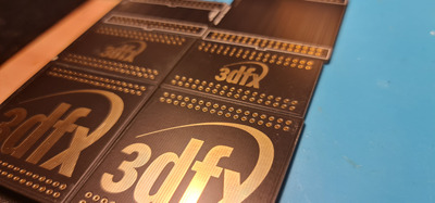

You're right, there isn't much difference between the designs. Technically, the one with the reference plane is better, but in the case of the V2 it doesn't matter, the SLI interface is already dumbed down in the driver to work with the shitty cable.
I'll upload some better pictures with the gold logo 😀
As for the old logo, does anybody have that in some vector format?

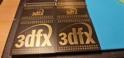

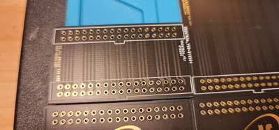

Reply 62 of 102, by sdz
Maybe these looks better:
984.21 KiB
786 views
833.69 KiB
786 views
1.24 MiB
786 views
Not the best photos, the gold looks a bit tarnished, but it doesn't look that way in real life. Maybe I'll replace these with some proper pictures if can find my camera battery charger.
Reply 63 of 102, by Sphere478
yes, very nice. to make the gold logo work like that I would have to reverse most of my changes. which brings me to wonder, maybe I should just talk with you about your spares? 😀 pm me?

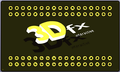

Reply 66 of 102, by wiretap
I guess I'll throw one in the pile too.. 🤣. I tried to make the 3-dimensional logo in silkscreen. Turned out ok, 🤣. I made it a 4-layer board too, so all the traces are hidden inside and the outer layers are as clean as possible.

Reply 67 of 102, by Sphere478
That logo turned out better than mine when I tried.
Might host it here also incase link ever goes dead.
You could Convert the silkscreen to solder mask and make it gold :p

Reply 68 of 102, by matze79
wiretap wrote on 2022-09-19, 17:08:
https://github.com/wiretap-retro/3DFX-SLI-Bridge
Maybe it will look more 3D Dimensional if soldermask is removed in some portions too.

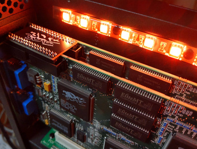

Reply 69 of 102, by wiretap
Assembled and tested mine this morning. Works great. 😀

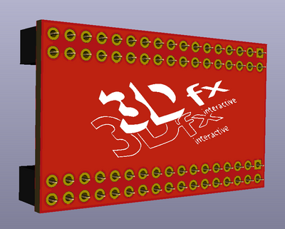

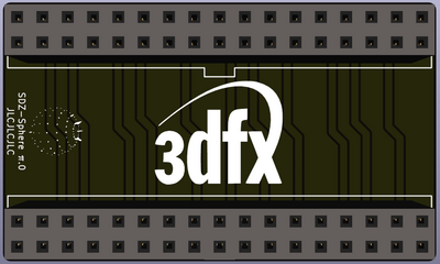

I have made some improvements. big traces, massive ground plane, 4 layer, and sick logo! suggest ordering in 1.6mm PCB thickness with gold finger enabled, and the process that keeps the gold from getting covered with solder. This should have better signal integrity than previous design and oem cable. ordering without gold settings will give solder colored "3D" logo. Which is fine, if you want that.
matze79 good idea with the solder mask. believe it or not, that was edited by hand...... 😳
Credit to wiretap for the unedited logo.
If I understand it, this bridge is actually passing analog video signals, which makes anything we can do to beef up signal integrity a good thing.
