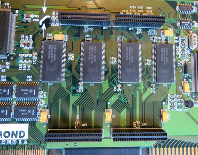

The artifacting reduced by 95% when using the 33 MHz front-side bus on the Daewoo board, compared to 40 MHz on the Asus board. Whether the artifacting is due to an overloaded bus on a long/crowded PCB, or due to or ageing silicon, I don't know, but I suspect the former. I don't think Diamond had a whole lot of sales with the MVP-2000 targeting the VLB platform. Looking through the manual, the VLB variant notes show up in the addendum.
Even with the artificating, it only shows up temporarily on the screen surrounding the overlay box. Once you refresh the desktop, the artifacting disappears. It would be interesting to test the same MVP-2000 board in a PCI system with a 40 MHz FSB.
Any idea who IBM was buying the VRAM from in 1994-1995?
Speaking of the VRAM, the NEC memory I had ordered had some of the surface print ruined (evident on page 2). This was because the manufacturer had placed tape over the IC's to hold them onto a foam backing board. I'm not sure why they weren't sold in tubes. Possible fakes? Removing the tape pulled some of the wording off. I was able to fix the wording, for the most part, using some thermal grease and isopropyl. The lack of consistency in the black colour on the casing of the IC makes me suspect they are fakes. Has anyone seen this non-homogeneous zone in the black plastic casing on memory modules?
Shown below are the fixes. Goofed up RAM print is on page 2 of this thread, here: download/file.php?id=131329&mode=view

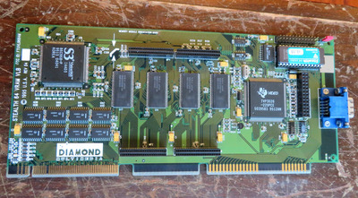

Clarity on the plot:
1) Diamond VLB with IBM memory and IBM 2 MB memory module has no artifacting (because MVP-2000 decoder card not installed)
2) Diamond VLB card with NEC memory and NEC 2 MB memory module has no artifacting (because MVP-2000 not installed)
3) Diamond card MVP-2000 decoder card shows artifacting with IBM memory and with NEC memory only when using the overlay video window. Swapping from IBM 70 ns to NEC 60 ns did not help with artifacting.
4) I noticed some additional issues with the MVP-2000 decoder card having the NEC memory installed, that is, I saw some artifacting when not using the decoder card. This never happened before. Possibly some memory incompatibility, a bad RAM module, or a bad solder job. These SMD chips are pretty easy to solder and I would be surprised if it was a bad joint. I put the IBM memory back onto the MVP-2000 card and the non-overlay-related artificating is gone. Still have just the overlay artifacting.
5) I am currently using the Diamond card with 4x NEC memory chips on the VLB card and 4x IBM chips on the MVP-2000 card. It is only the MVP-2000 which didn't like the NEC memory.
6) Moved the VLB+MVP2000 to a new, slower system, using the IBM BL3-100 at 33 MHz FSB, rather than the Am5x86-160 at 40 MHz FSB. The artifacting almost disappeared entirely.
Another user here, elianda, also has this hardware combination. His website: https://retronn.de/imports/hwgal/hw_graphics_ … 2000_front.html When discussing with him in private, he didn't notice any artifiacting on his, I think, DX2-66 system. Thus, I suspect there is some aspect of my particular hardware which does not cope well with 40 MHz. I pulled my MVP-2000 from a PCI card. I think user elianda got his with a VLB card, but I'd have to check my notes on this. However, I was also using a SCSI VLB card on my Am5x86-160 system, and the L1 was in WB mode.
I think I have some Samsung and OKI branded 60ns EDO VRAM (256Kx16) I could try on the MVP-2000, but I don't really want to disturb the RAM again when the hardware is working well at 33 MHz. The extreme artifacting I showed photos of with Am5x86-160/40 does not occur on my BL3-100/33 system. I might get a blue pixel here and there.
EDIT: I checked my parts bin. Aside from the IBM 025171LG5B-70 and NEC D482445GW-60, I have some desoldered OKI MSM5416263-60, which is also EDO, 256kx16, and SOP64. According to the datasheet, they also came in 50 ns.
