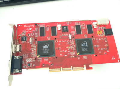

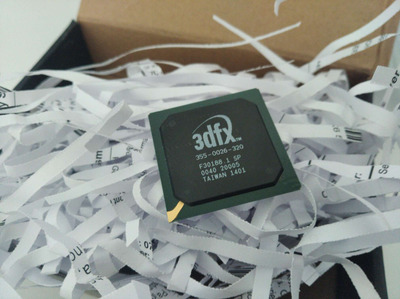

While Im in the process of testing WinXp drivers (that isnt going as expected) some intermezzo
Card survived the chip change.
177.96 KiB
2478 views
With some minor pins lovemaking... You got to have some drama in life... They managed to fix it without the need to reball.
10.96 KiB
2478 views
There was some shitty soldering where the fan power resistor is (ofc cus I did it 😁), so that got a quick fix too.
Funny thing... I told him.. I did something to one of the 3pin connectors wont tell you which one, 1s later, he re-soldered the one I did, looked at the one from Anthony, nah that ones good. God damn 😁

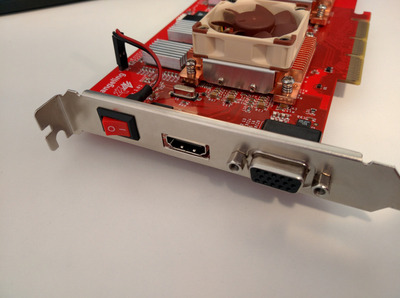

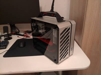

Since I use a glass panel case, kinda a pain to move that memory jumper if I ever need to.
1.78 MiB
2273 views
So added a switch to the bracket
1.6 MiB
2273 views

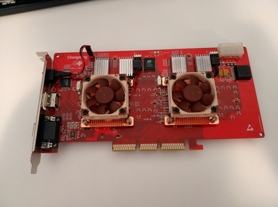

Card also got the copper coolers Anthony used before, didnt do a comparison, but I like how the mount and look, so they stay put.
1.71 MiB
2273 views
Also tried small vcore increase to 3v, but while it resulted in a few mhz more, still not 200mhz, that Im aiming for, so removed it.
